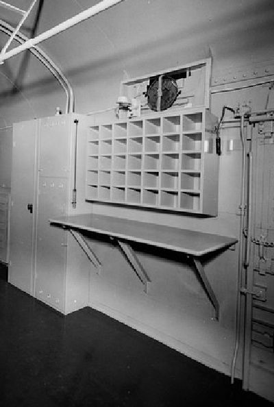

Definition #2 from Webster-Merriam:
pigeonhole noun
pi·​geon·​hole | \ˈpi-jən-ˌhōl\
Definition of pigeonhole
1 : a hole or small recess for pigeons to nest
2 : a small open compartment (as in a desk or cabinet) for keeping letters or documents
3 : a neat category which usually fails to reflect actual complexities
The pigeonholes are above the work desk in the image below.
