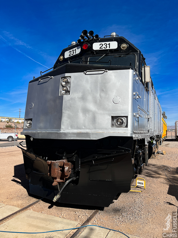

A long overdue update to the DynaRail website just went live-- pics of this year's restoration work on F40 locomotive 231 located in Boulder City, NV. New windshields were purchased and installed; 250A aux. generator breaker replaced; carbody prepped and painted in Platinum Mist and black; and misc. repairs done to air lines and electrical wires. The next step in this repaint process is applying the red, white, and blue stripes, and for that, we need to raise $2000 to place the paint order, and get paint supplies, such as masking tape and paper/plastic (at least 1,600 linear feet total), strainers, etc. Donations are absolutely welcome!
Pics of this year's work: https://www.dynarail.org/galleries/2023repaint.html
Tax exemption and donation info: https://www.dynarail.org/contact.html
231 fired up and idling in Sept: https://www.youtube.com/watch?v=kFacpb_Qy2o
Once the stripes and decals are complete, we'll shift toward sourcing and reconnecting traction motor cables, and fuel needed for further fire-ups and testing, which will bring it one step closer to having it operational. Exciting times ahead!
