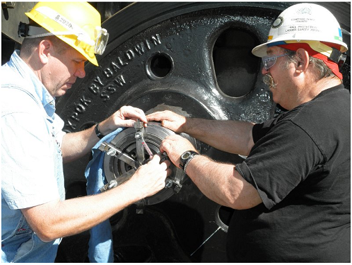

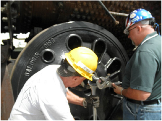

From the August 3 post:
Three Boxpok and a Baldwin Disc. 'Baldwin Disc' and Boxpok markings opposite the CWs. No ribs on these discs though. And the labels:
