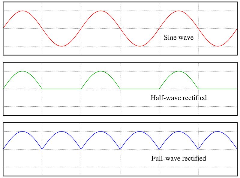

Jayrod,
What do you mean by pulsed DC? Does the voltage spike 120 or 60 times per second?

Rick - that analogy will work. It’s like the voltage turns on and off X cycles per second is the simplest way to put it. A simple filter utilizes an electrolytic capacitor to smooth those the pulses out. It stores a charge to fill in the gaps so to speak. That’s about as simple as I can explain it without getting technical. That’s why incandescent bulbs running on pure DC can last a lot longer - no thermal stress from the on/off cycling. Given the right circumstances, they can run for decades on DC.

Rick,
Here is a picture that may help. The pulsating DC would be unfiltered:

Perfect illustration. The tops and bottoms of the sine wave or AC could be considered +12V and -12V (not to be confused with ground) respectively. The line through the middle is 0V. You only want the +12. Hence the full or half wave rectifier. The filter smooths out the bumps by filling in the the missing parts so your line becomes flat at +12V DC.
