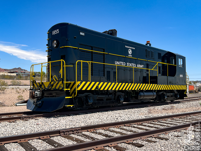

USAX #1855 at Nevada State Railroad Museum in Boulder City, NV (just outside Las Vegas) was just repainted back to its US Army scheme.
