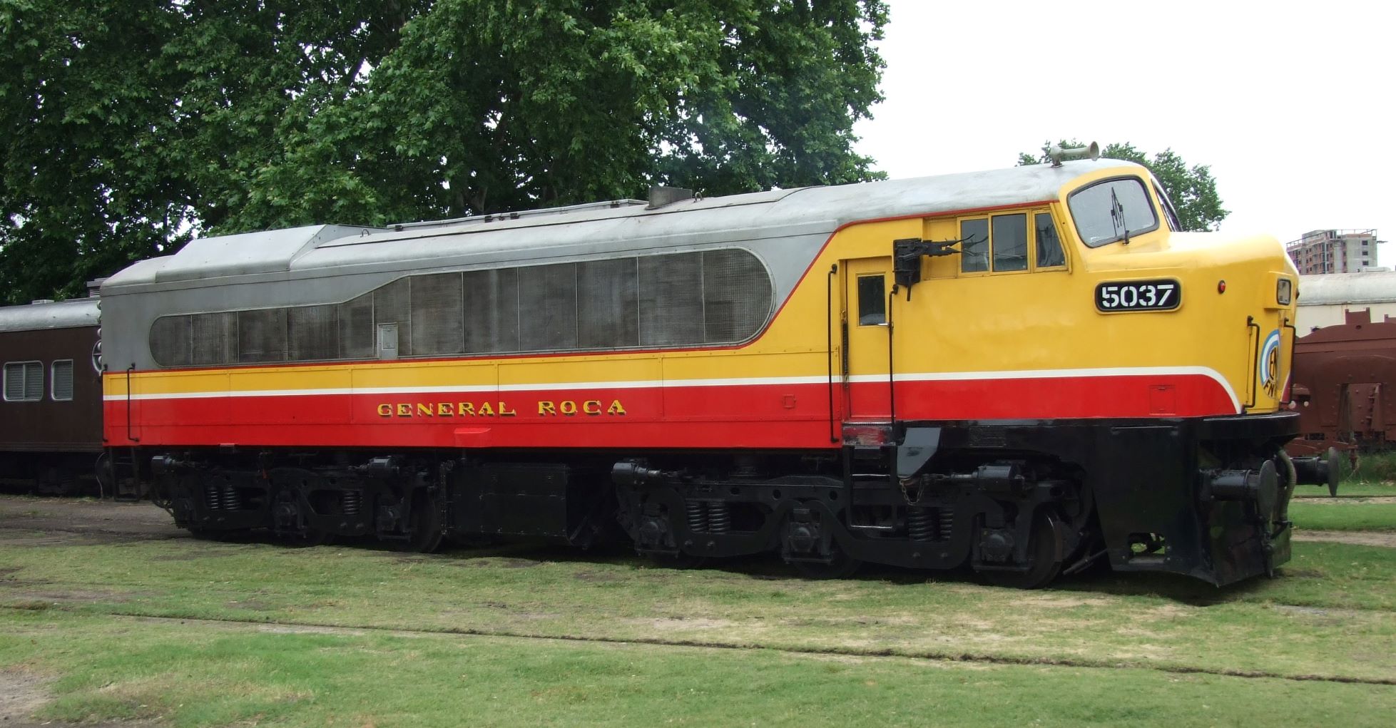

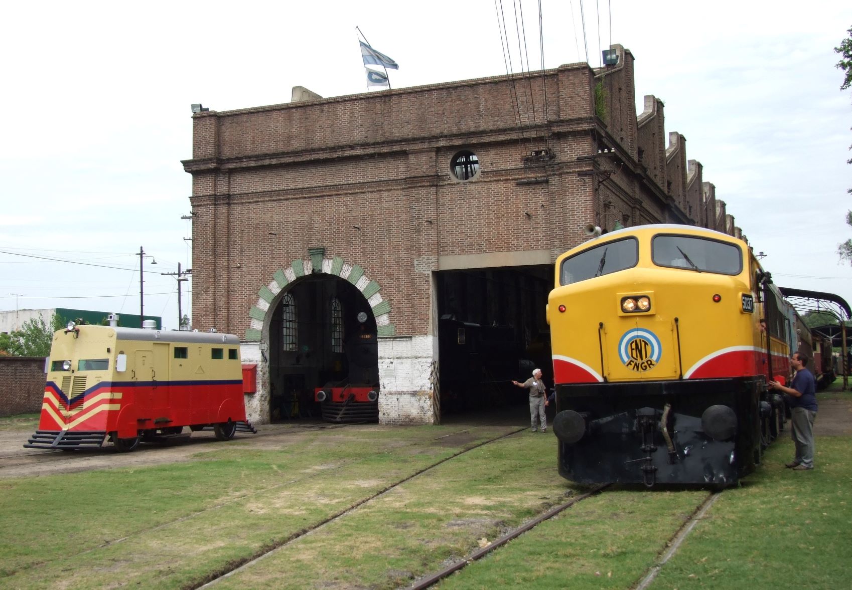

Not quite the same, but don't forget there are some Baldwin RF615E broad gauge locos with a "sharkish" style front end preserved in Argentina.
This one, preserved by Ferroclub in Buenos Aires, was certainly operational in 2007.....

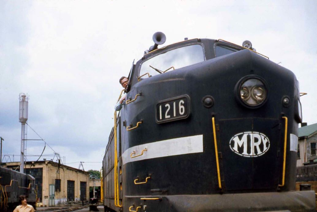

Was looking for something else and found this:
