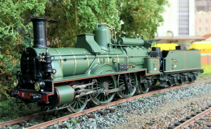

The comments section yielded a link to a more current picture of a model of the locomotive. No kidding, it's green... LOL
