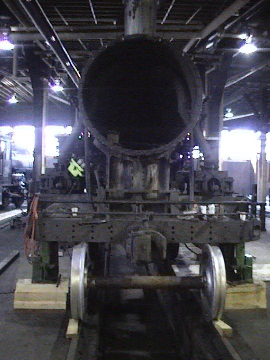

Here is the front end before they jacked it. Notice the location of the wheels compared to pilot beam in this pic.
File comment: This is after they jacked it.

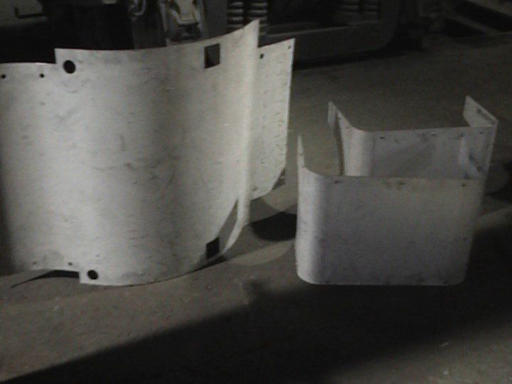

File comment: New sheet metal

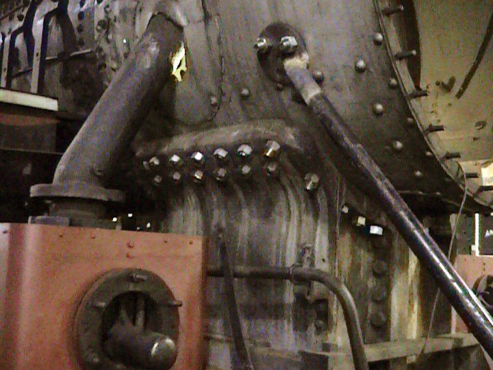

In this pic its hard to see but this is the mid support for the boiler. It was gapped at least 3/4" before they jacked her.

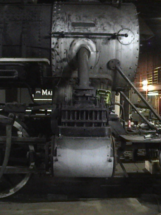

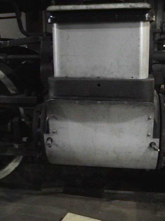

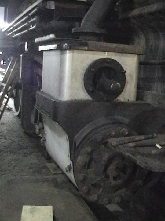

Cylinders and valves all done!

After 30 years the boiler and chassis have been bolted back together! Congrats to everyone who is working on her since I left. Thanks to Len and Gary's crew for the hard work. We are making huge progress on 565.
Leonard; This week we were able to get all the bolts installed to hold the boiler to the frame. We have 3 bolts yet that were damaged and need replaced. But, we have all 42 of the 1-1/4" bolts that hold the cylinders to the smokebox driven in hard and impact tightened. We have the 6 - 1-1/8" bolts in and tight that hold the front beam diagonal braces to the smokebox. We have all the 7/8" bolts tight in the first waist sheet. I welded the second waist sheet back together - but the welds need dress ground to finish.
We did not do anything with the 8 bolts at the front of the firebox on the furnace bearers. They need tightened - maybe one replaced - and some new plates fitted.
We did install and finish tighten all the bolts at the rear waist sheet to the mudring fit.
I took the new metal to a machine shop and they are producing the duplicate pedestal binder for the R-1 using the L-1 as a pattern.
We have the bolts also to tighten the branch pipes to the valve chests. I'll try to get them in and tight.

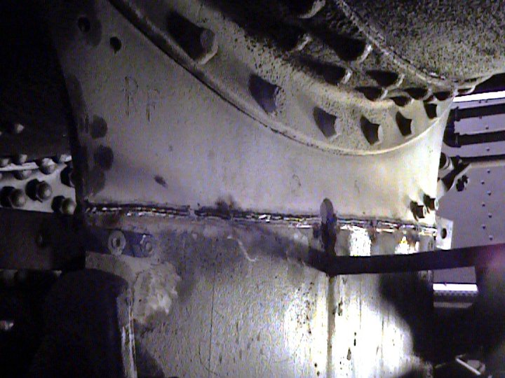

The Mid-Boiler support welded back together!

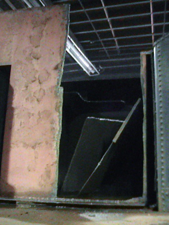

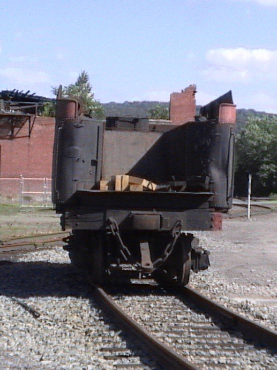

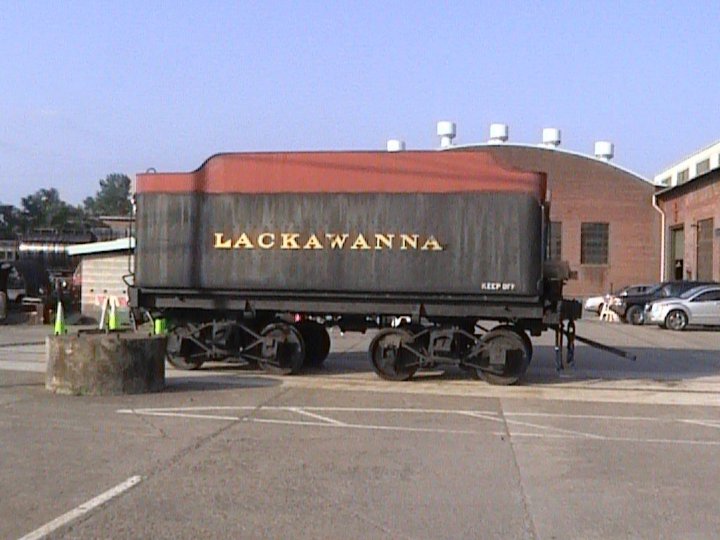

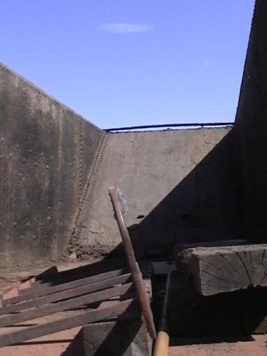

More progress!!!!!! The tender was moved to the backshop and the oil tank was lifted and removed by Gary and his crew. Once on the ground, Len and the gang cut it up and we are keeping the steel for making new coal bunker doors and repairs to the coal bunker itself.
The tender with no oil tank.
Close up of the coal bunker
Side view of the tender
