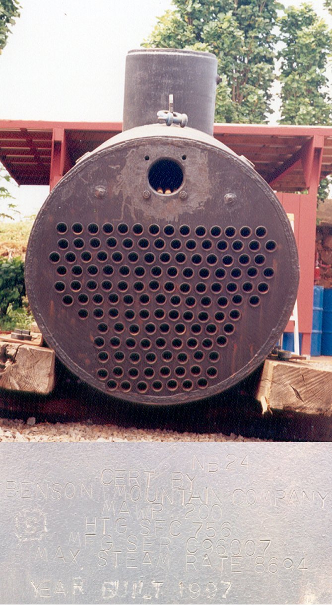

File comment: The owner of this boiler refused access to the boiler for the purpose of grinding the Stamp off until reimbursed for the costs of a real boiler. The price was $120,000. I heard 3rd hand the inspector enjoys a new line of work. Eight other vessels stamped by this manufacturer had the Code symbols ground off.
The dry pipe seating bevel was machined with a hand grinder. But what is odd about the staying of the head above the tubes?

Matt, what's the deal with the lower rows of flues? They appear to not be in complete symmetry and the bottom row appears to have the flue on one end right up against the shell and infringing on the weld zone of the shell to the flue sheet. Is this typical work or part of the problems with this boiler?

There is no Code paragraph that says you can't free hand mag drill a tube sheet. There are a few paragraphs that deal with the consequences of that practice, however. I found my stack of OR&L #85 boiler pictures, but that is another saga for another day.

PS: The flue sheet shown in Matt's photo is an excellent example of what not to do. It is very sloppy work. Also of note is the lack of stays in the flue sheet at the 4 and 7 o'clock positions. There is a limit as to how far the flues can be from the shell before additional stays are required. Because of the lack of uniformity in the flue layout, each flue and the area around the flue would have to be evaluated. Not knowing the dimensions on this flue sheet, I cannot state whether or not stays are required; only that it represents an area of concern to me.
The overlap of the flues at the flue to shell weld are also a concern. This would have to be evaluated to see if the weld in this area is of sufficient strength.
The stay design in the upper portion of the flue sheet is also a concern. I am assuming that the large opening in the upper portion of the flue sheet is for the pipe or operating rod extending to a possible steam dome throttle. If this is so, I would be concerned about the reinforcement required around this opening.
