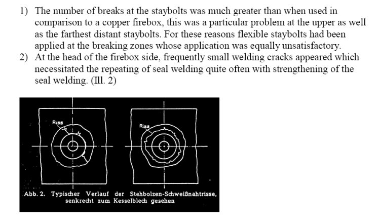

First off, I strongly reject the contention that the premature failure is due to sloppy operating practice or poor locomotive management. This organization spent 18+ years and $6M+ to construct an all new locomotive. How conceivable is it that they would turn the operations over to some neophyte engine crews to beat the crap out of it? NOT VERY LIKELY.
I would suggest that those who intend to follow this closely, avail themselves of the Tross analysis translations provided by Matt Janssen and available on the Wasatch RRC website.
Tross spent 9 years generating data related to poor performance of steel fireboxes in boiler backends that worked well with copper fireboxes.
Please note the radial cracks at the 5 o'clock and 11 o'clock positions of Image 2 and at Image 3.
FROM: Rear Boiler Knowledge:
Please note the radial cracks at the 7 o'clock and 1 o'clock positions of the back side of the mud trough/side sheet sample from the German boiler which would reflect to the 5 and 11 o'clock positions on the fireside in Image 2 and lower left side of Image 3.
As described in the Tross text, this cracking resulted in sheet replacement in as little as 60,000 miles. Minor design changes such as increase in firebox sheet thickness could grossly increase the onset of cracking.
