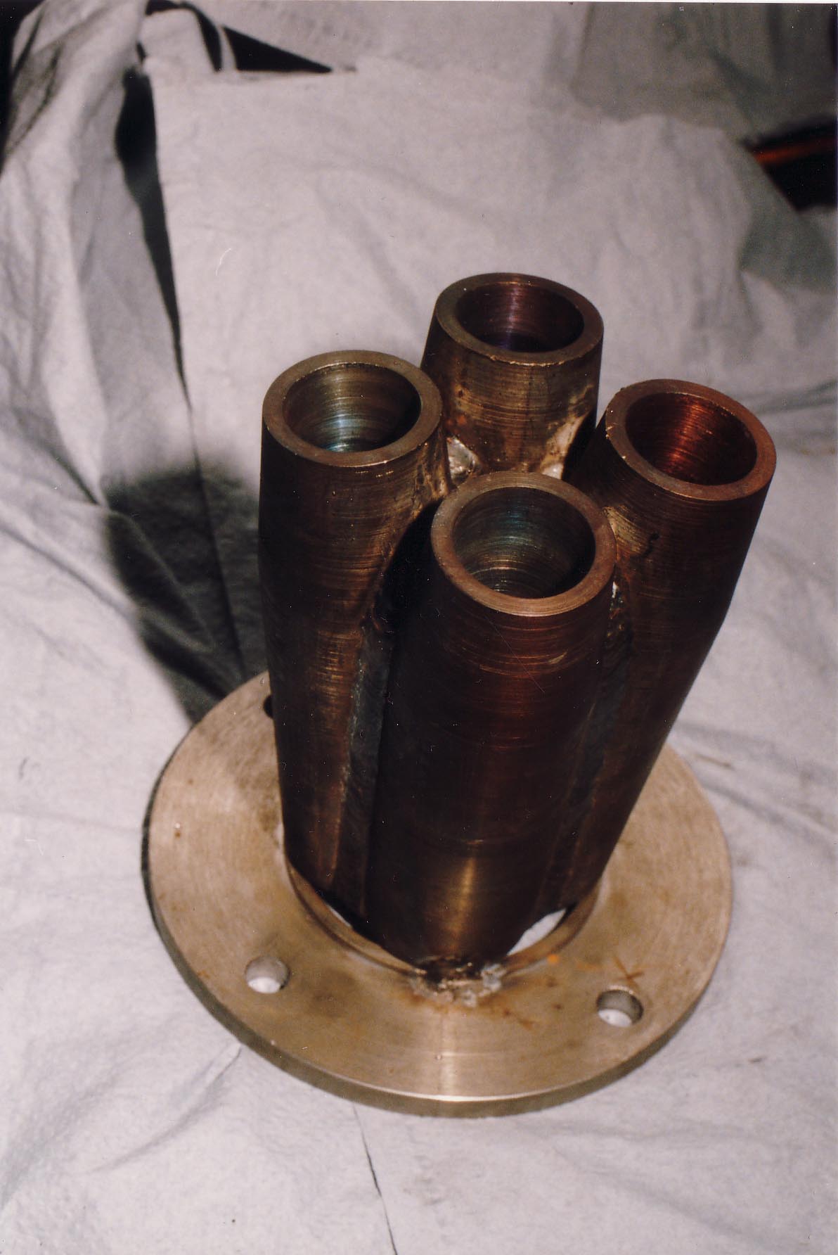

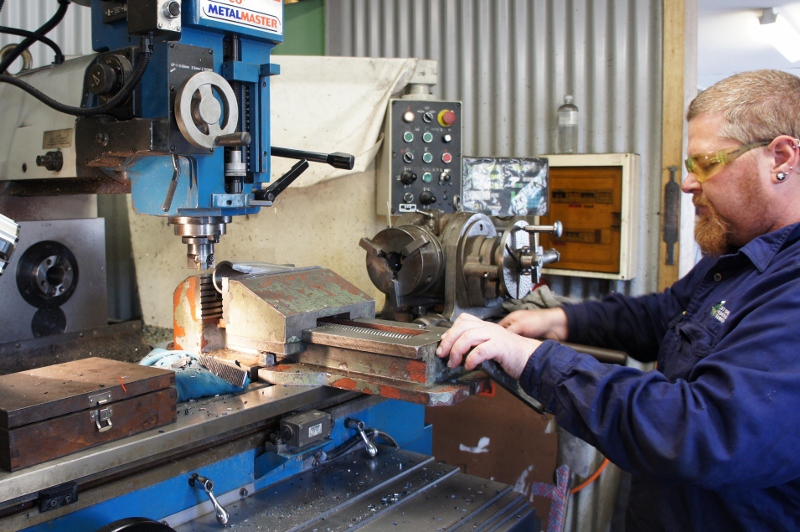

More from Nigel:

 Post subject: Re: Lempor Exhaust Nozzles
PostPosted: Wed Jul 20, 2011 8:44 pm
Posts: 216
Location: Pittsburgh PA

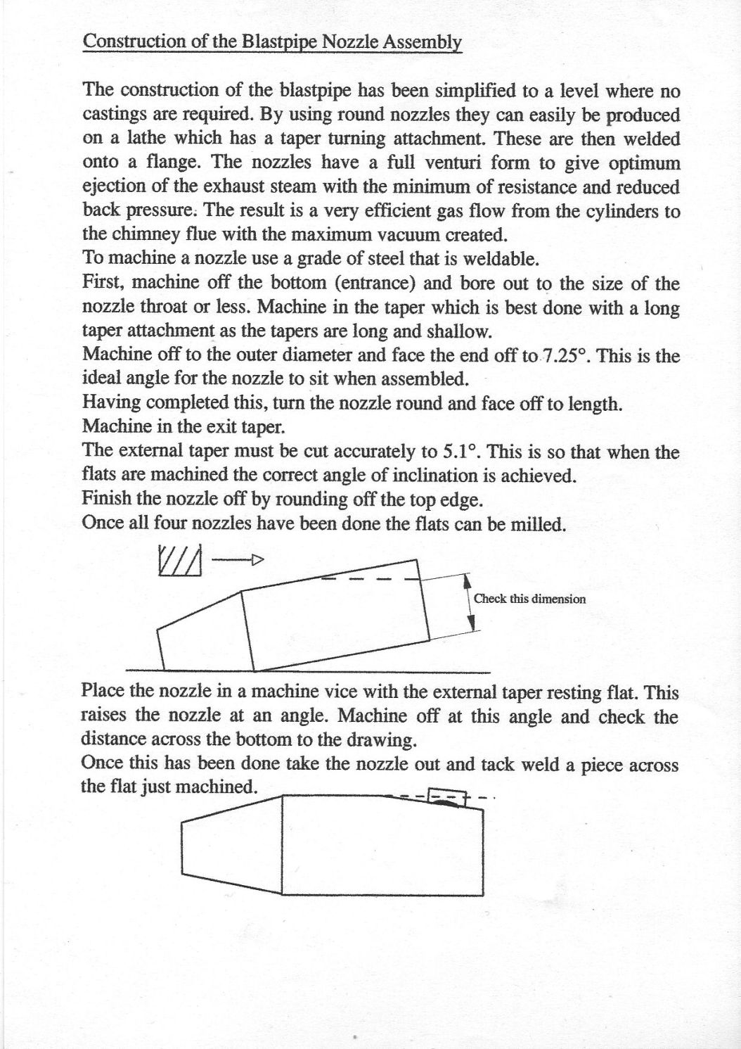

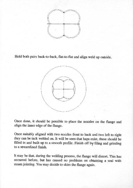

More from Nigel - apologies for the difference in sizes...

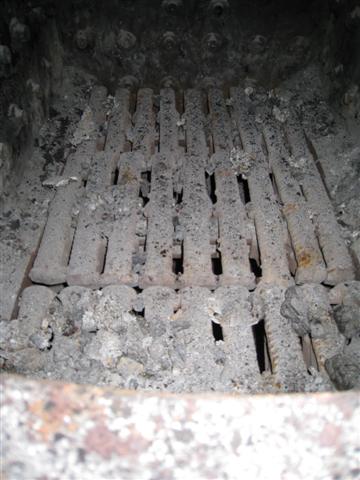

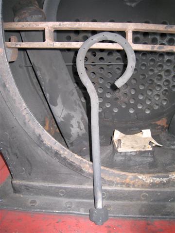

Today was work day on the Fowler and the Blacksmiths Hammer.
I was going to fit the eccentric rods but the machinist who turned the new pins hardened them without putting pin holes in them, bugger any how I got the post holes for the forge shed boxed up read to pour concrete.
Nigel more dimensions for you.
The Blower ring I.D is 0.675" O.D. - 0.895" x 11 -0.125" diameter holes.
Cylinder Diameters are 11.0625"
The Area of the modified Hulson firebars air gaps is about 243 square inches.

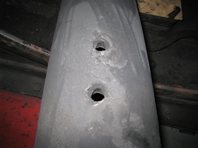

Having a look at the Blast Pipe stand I found that it had 2 x 0.625" Tapped holes in the back of it which faced the tubeplate. I wonder what they were for? I would not have known they were there if I had not decided to have a good look at the pipe.
I have ordered hollow bar 55mm x 30mm actual O.D. is 57.1mm and 26mm I,D.
Yes we are very fortunate that Nigel has chosen to bless up with his knowledge on exhaust systems its more than I ever hoped for. All I have to offer is what I have observed operating many different types of boilers over 47 years.
However I do have a pretty good digital library including Suggested Unit Course For Locomotive Firing, by the University of the State of New York State Education Department. Ask me, I might have it to share.

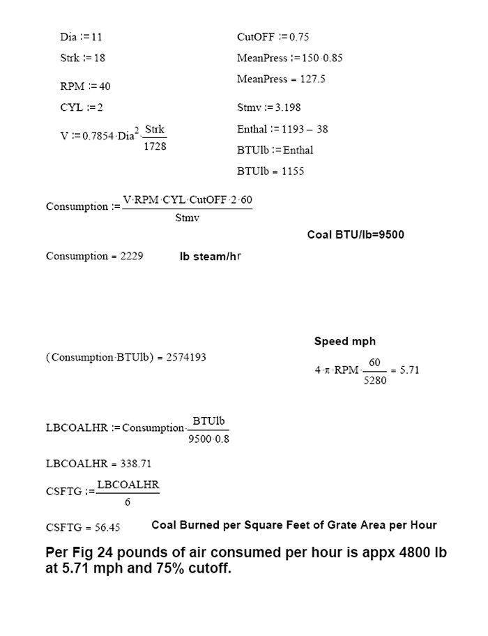

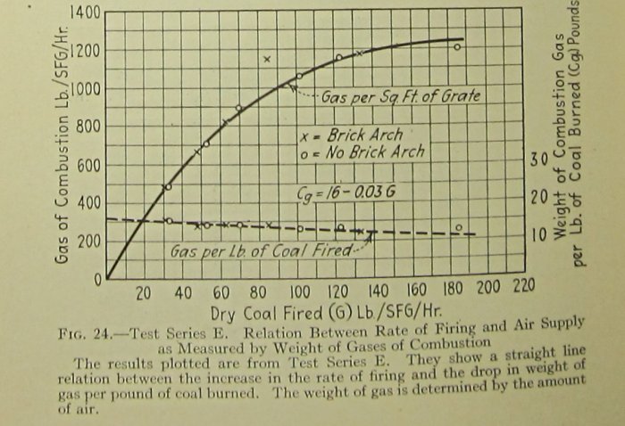

Just a few combustion considerations.
A few BTU calculations as to how many BTUs can you get out of 6 square feet of grate area. Especially trying to burn 30% worthless per pound coal with only 9500 BTU per lb heat content.
Assumptions are 75% cutoff, 48" dia drivers, 5.7 miles per hour, 127 psi mean steam pressure and a generous 80% thermal efficiency.
Note that about 14 lbs of air are required for each lb of coal.
The boiler that I designed, fabricated and welded on Maui for the Kahului Railroad #1 (Baldwin 1882) also has 6 sq ft of grate area. However, only 58 1.5"OD tubes, 6' 8" long and a 28" diameter barrel. Cylinders are 8" x 12".
Fig 24 is copied from "A Study of the Locomotive Boiler" by Lawford Fry published in 1924.

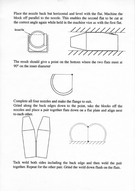

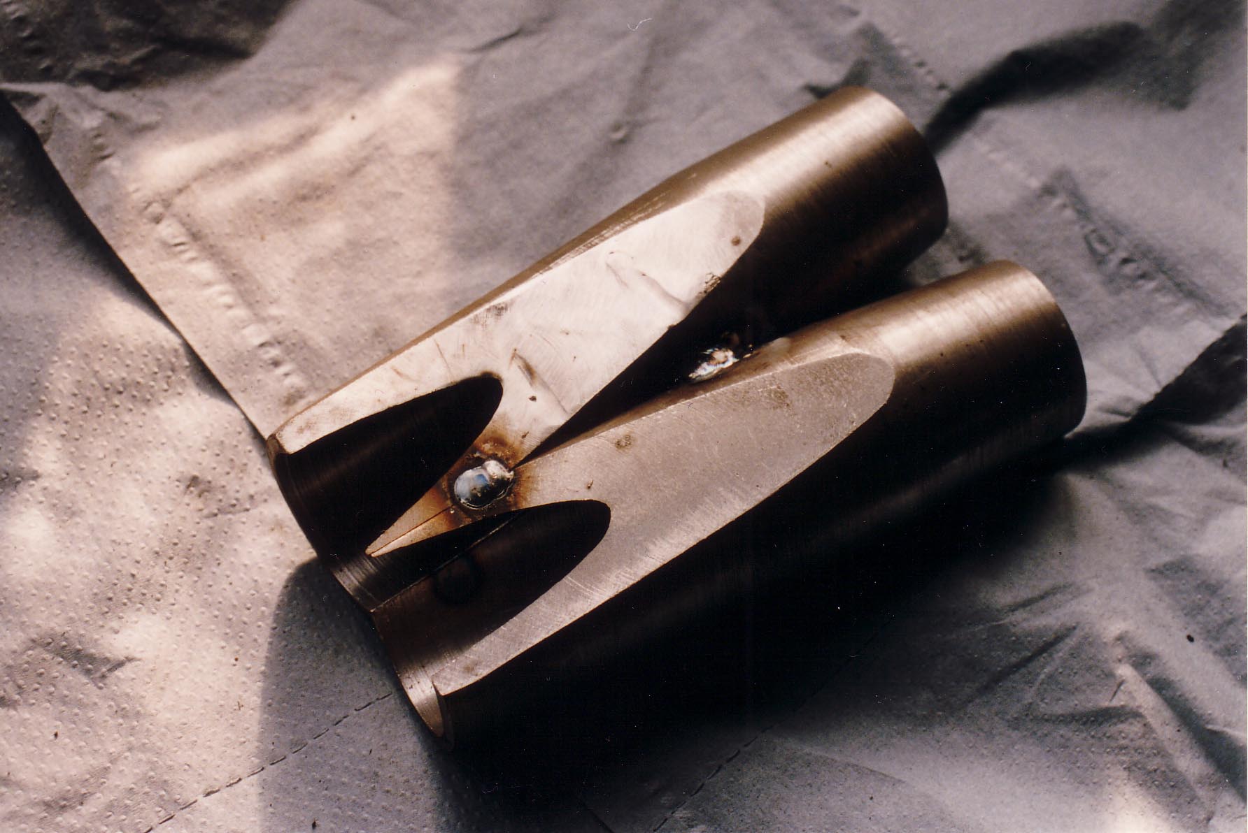

I am pleased people are finding it intresting. I thank Stephen and Tim for putting the pictures up. Not much more to explain.
I hope the instructions on how to mill the nozzles are now clear. The dimention across the base which needs checking is 44.25mm thus giving a point at the tip where all 4 nozzles meet at the centre. In a day or so I will do another drawring to ilustrate that and have done the blower calculation. I know already that there are to many holes in the blower ring and thus the velocity out of them is to low to create a good draught.
The last three photos show the milling of the nozzle flats and asembly of the nozzles. I have a few more to come espeshaly for the finishing of the welding and streamlining of the flange- nozzle area.
Thank you for the combustion coments , intresting but for now I am going to limit my coments to the draughting. Certainly we will have the ability to shift the air for such coal.
Less words, more hardware. Only what others say can not be done is worth doing.
