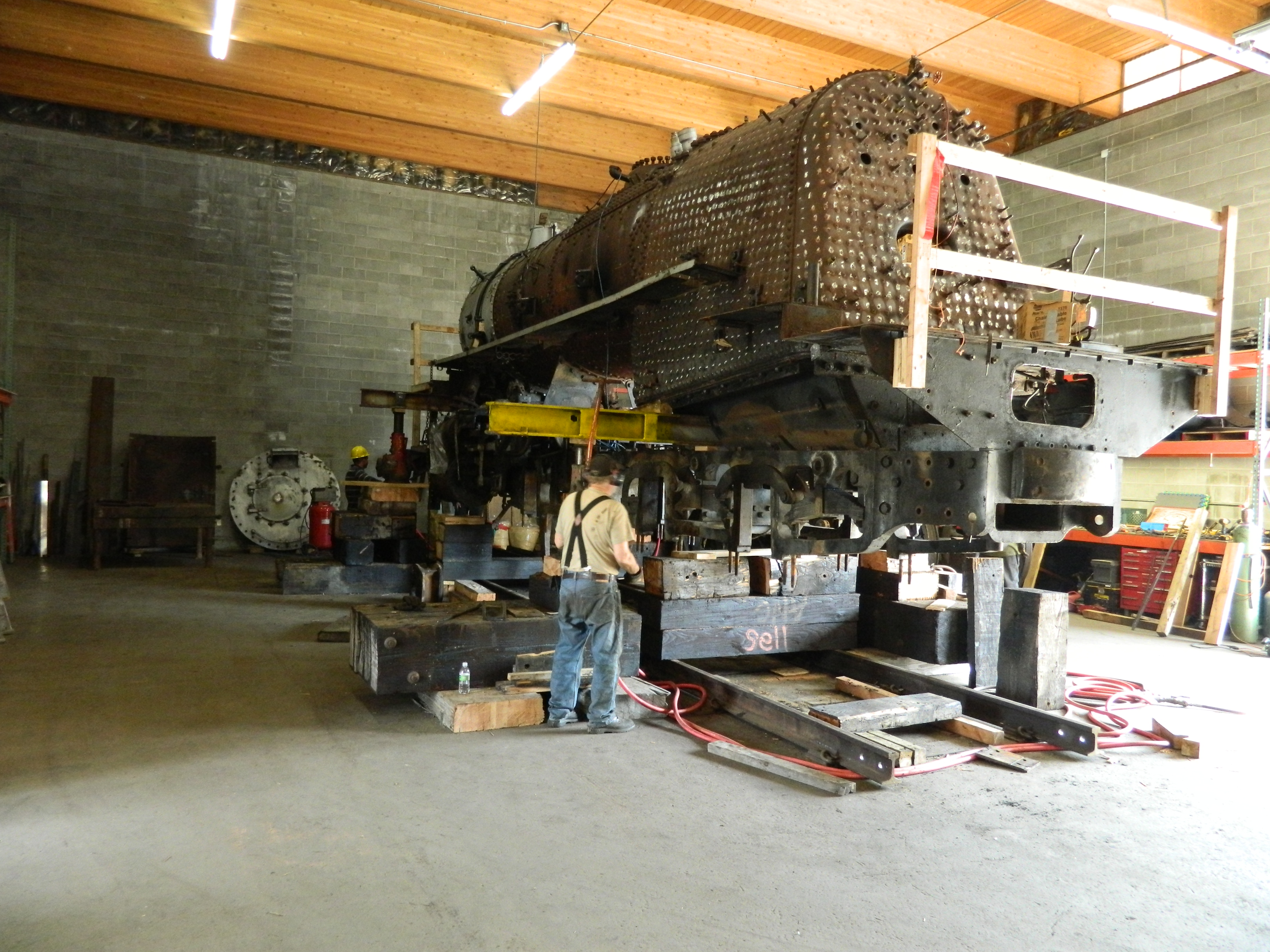

I have an update to any that are interested. UT's are done and it looks as if the firebox will be replaced in its entirety. Fire box flue sheet is badly fractured in multiple locations. Some exterior wastage that will need to be replaced. Spring rigging is shot. Brake rigging will need bored and bushed. #1 driver crown brass beat out and scorched, other drivers not to bad. This is just a qiuck note, there is a lot more to do.Image

557 mechanic... I hope you don't mind, but I put your photo through my photobucket account, so it is a bit easier to see the entire photo.

I would be a bit nervous jacking under the front of the firebox and smokebox. Maybe it's just me.
