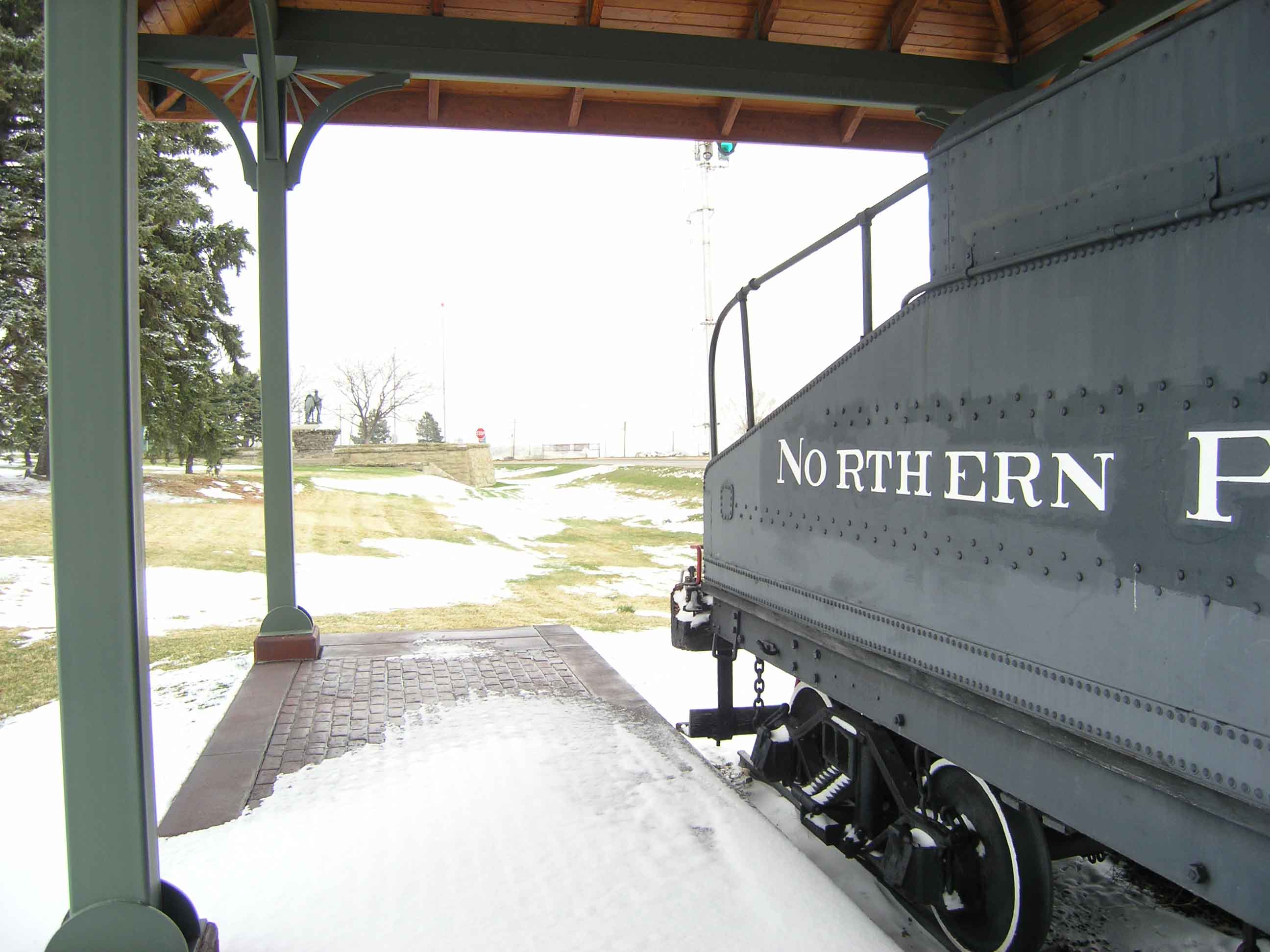

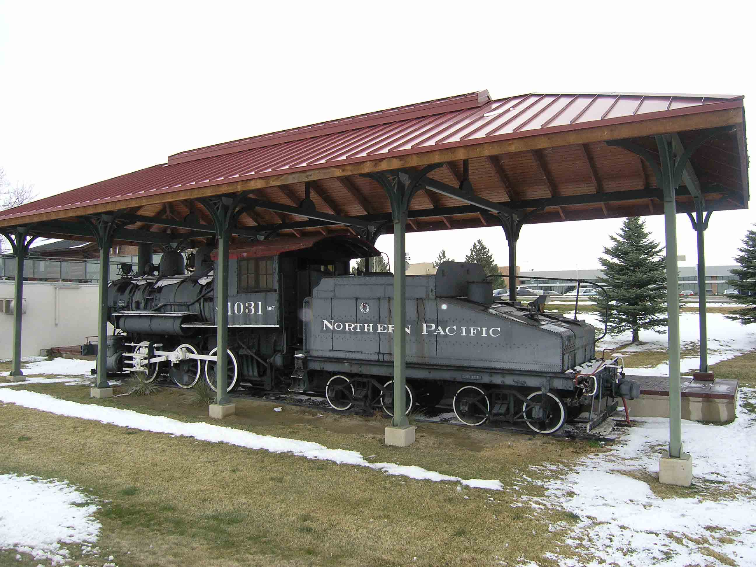

I think the shelter in Billings, Montana is the nicest one that I have seen.

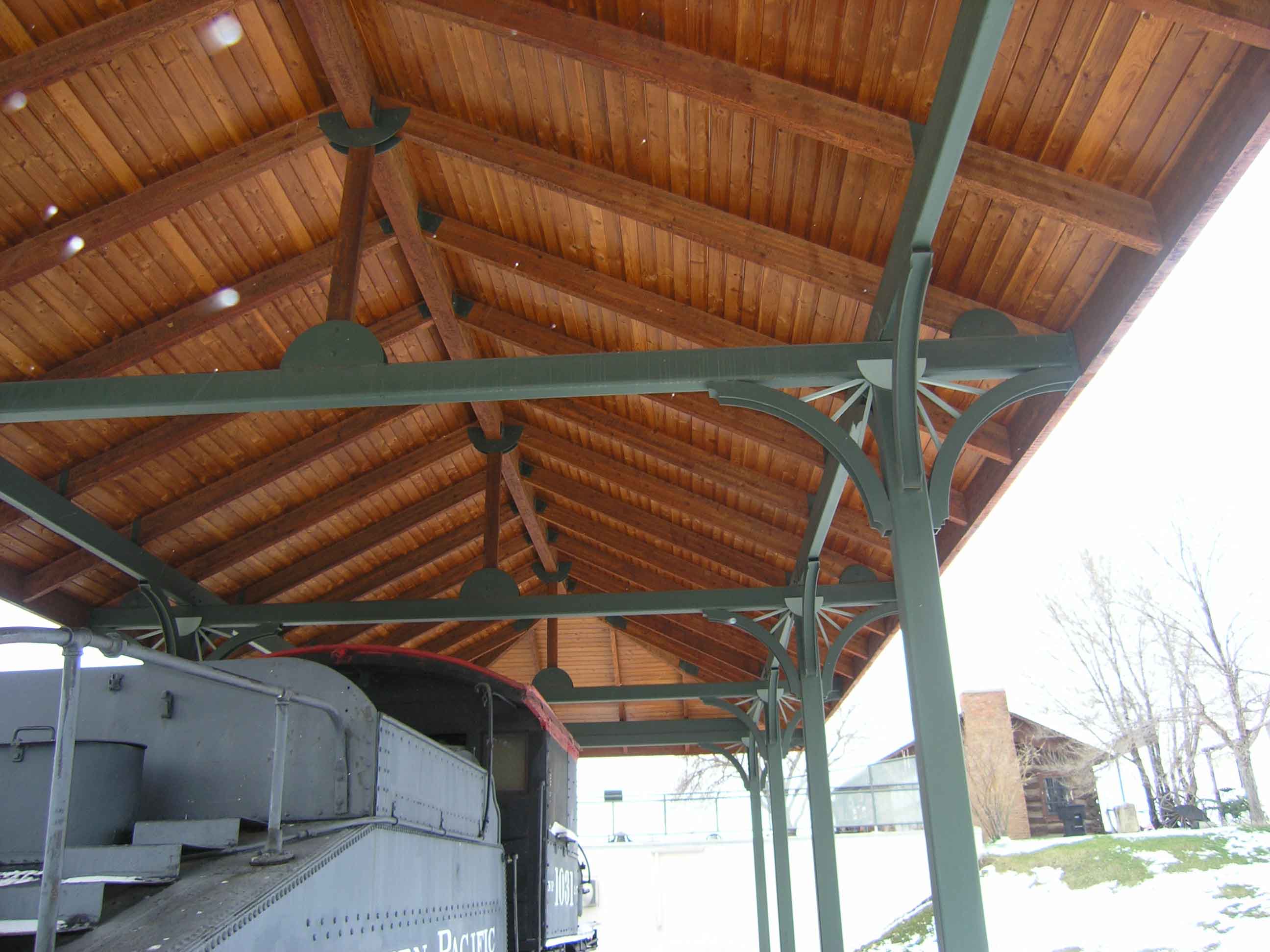

The NP 1031 photos demonstrate that even nicely designed, attractive and wide(er) display sheds can't fully protect from the elements...there's blowing snow up on top of the boiler and tender...and the resulting trickle of melt water seeping into every available opening.
In a perfect world we'd all be able to afford fully enclosed, climate-controlled display buildings with plenty of good light and lots of space to be able to get those great photos...
