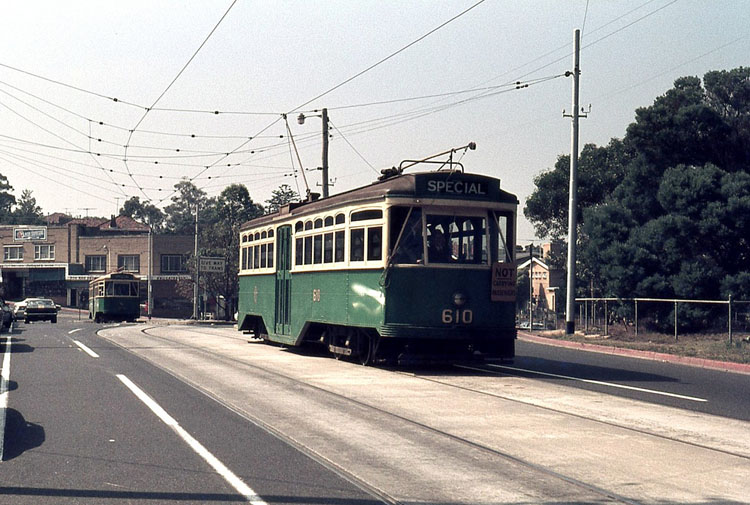

The trucks that are being modified for Dallas 754 were originally under a Melbourne MMTB Y-1 class car. Only four Y-1s were built in the late 1920s. They were a lightweight car built to the Peter Witt design. The cars were quite handsome but were not liked by the motormen (easy to convert to 1 man operation might be their thinking). Couple that dislike with the onset of the Depression and no more were built. There is one remaining car with different more modern Melbourne trucks under it.
