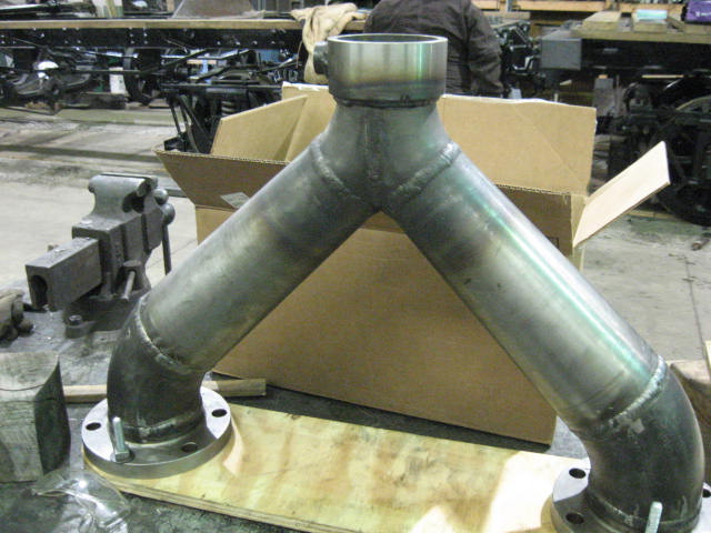

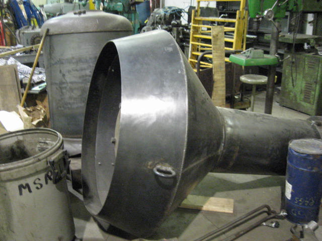

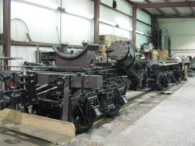

Couple of pics from today.
-New exhaust nozzle piping
-Newly fabricated diamond stack
-Overall Chassis shot

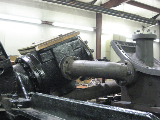

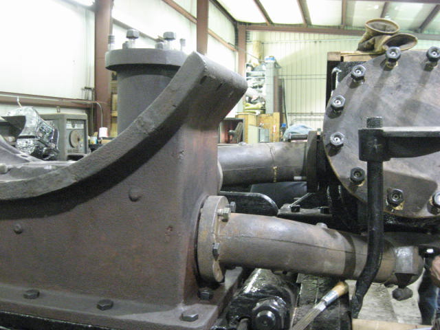

Steam Intake/Exhaust piping.

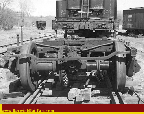

Photo of the rear truck from the Carroll Park and Western Climax taken in 1963. Looks like the bolts on the right side are installed so the nuts can be threaded on from the top.
