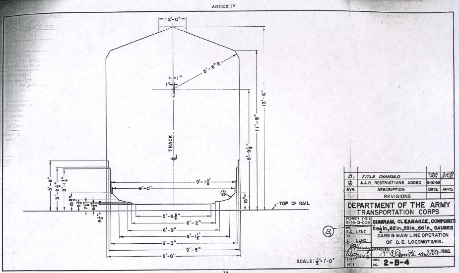

The AAR Coulper with in type E the it on loco I at maybe correct need.
The Check centerline of the Knuckle above track (34 1/2 inches standard).
Willson so be the Type E Coulper (41 inches from the rail).
The Draft Gear in move in low position or higher position for use the "Willson Coupler".
I a Pacific Southwest Railway Museum an the 1 ALCo-GE RSX-4 an 2 EMD MRS-1.
The will put clearance in attachment of EMD MRS-1 that used in France.
Stan
This a EMD in France:
2) France
Starting on september 24, 1953, the unit was stationed for six months at the depot of Saintes (région Ouest), France for the same purpose it had in Belgium and Germany. The unit was renumbered in France to '060 DU' It was mainly used for freight trains towards Bordeaux, La Rochelle and Angoulême, with a daily average distance travelled of 924 km. The unit was also used for a passenger train towards Paris-Charolais. The unit was also seen in Paris-Nord and Saint-Gervais-le-Fayet. In january 1954, the unit was transferred to the depot of Oullins, for static tests. The unit stayed in France until march 17, 1954, after which it went back to Germany.
Overview of services in France:
2.10.53 - 9.10.53: Freight trains, 2662 km travelled
10.10.53 - 31.10.53 and
6.11.53 - 20.11.53: Freight, 19115 km
21.11.53 - 8.12.53: Passenger services, 13085 km
9.12.53 - 11.12.53: test trains with control coach 'Mauzin', 13085 km
12.12.53 - 25.12.53: Passenger services, 8153 km
26.12.53 - 8.1.54: Freight, 5790 km
9.1.54 - 12.2.54: static testing and reprofiling of tyres in workshop La Folie. Also tests on january 25-27 between Lyon and Ambérieu. Passenger and Freight trains in Alpine region between Bellegarde and Saint-Gervais-le-Fayet in cold, blizzard, but keeping the timetables respected, even with slowdowns for track-works and closed signs!
13.2.54 - 27.2.54: Passenger services, 11474 km
28.2.54 - 10.3.54: New speed regulator installed
11.3.54 - 17.3.54: getting ready for transfer to Germany
The came EMD MRS 1818
http://www.railpictures.net/viewphoto.php?id=377825
You can see a Willsion Coulper it do a it.
Stan
File comment: The is a EMD that was create for over sea a 4' 8 1/2",5'0",5'3",5'6" Gauge.
The was to like is France a that is narrow tunnel.
The 13 EMD an 83 ALCo
