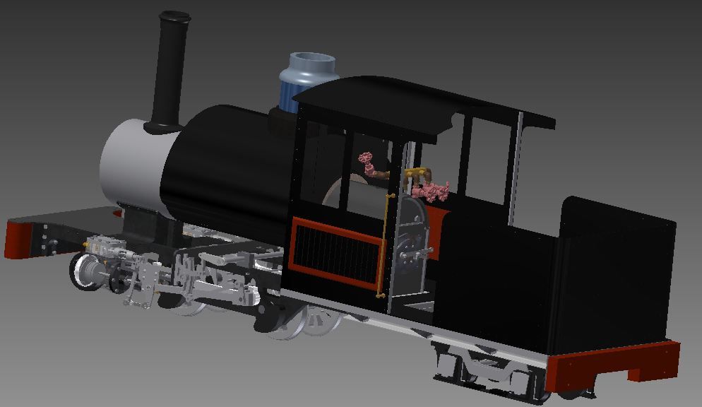

I strongly disagree with the latter part of that. If you are building a live steam locomotive and starting with an erecting drawing in my opinion actually building a 3D CAD model will save you lots of time as opposed to lengthening your project. I can knock out a cad model of simple parts in very little time, though I must admit that the latter steam casting drawings such as the type you will see on the T1 project and similar parts ordered from the suppliers can be a whole other story in terms of complexity. On the other hand it may take me 10 hours to machine a single part for my locomotive and and maybe I have two of them, well if you get to assembly time and the things don't fit and must be remade cause you messed something up the 30mins you saved modeling those parts in CAD really won't seem like much of a bargain!
In my case granted I was living in an apartment for some of the time but I built the 3D cad model and it was the best thing I could do. Here's a photo;
The plans offered by this manufacturer were terrible and loaded with parts from different locomotives, so the savings are huge. Having the 3D cad models has also allowed me to make changes to many of the parts to make them look more realistic. Your discussion about collaboration is an interesting one however. I have done a lot of work on my computer and it would seem like a shame to hog it amongst myself. I sure would love to find someone to trade and offload some of the design work with who was building the same locomotive.
Now for the harder part, my locomotive uses very simple parts in comparison to the final years of steam and those that existed in the superpower era. I have worked with some of those parts to convert them to 3D CAD and am presently volunteering to help convert some of the drawings for the T1 group. They can be a real challenge to work in. The old time draftsman really had unbelievable talents in some ways but were still human. Today those of us who work in the 3D CAD world are accustomed to parts that always resolve and geometry that always works. The computer won't let you build the 3D model if it doesn't work. On the other hand I have from time to time found geometries that just don't work on the old drawings. Oftentimes the projected views may not be 100% complete as the draftsman wouldn't bother to project a geometry if it was extra drawing time and they had already detailed it on one view. However sometimes just having that other view would be a huge help. Heck today we likely would put an isometric view on a print just to help show what was really happening. Those just didn't exist back in the day. I have a feeling that more often than not the pattern makers would have played somewhat of a role in fixing things that didn't resolve raiduses that didn't work etc... and the job would move on.
I realize this is somewhat of a ramble but my thoughts are to anyone building a steam locomotive of any size/scale build it in CAD first. It is till far less resources needed to fix problems on the computer than on the shop floor.

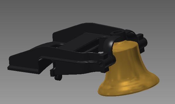

By the way, here's a fun one for example I did for a friend who will likely be offering it in 1.5" scale
If anyone out there wants to reproduce/needs a Hunt Spiller replacement bell for their Big Boy/Challenger and wants to get this 3D printed and cast please feel free to let me know.
