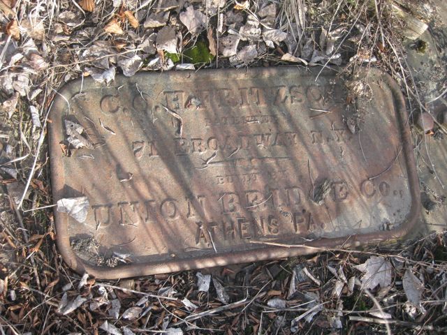

philip.marshall wrote:
elecuyer wrote:
For the record:
At the WW&F we have a steel turntable bridge that is not being used. I think it was repurposed as a road bridge at one time, then ended up at the WW&F before I was involved. I don't think we have any plans for it - as we are going to be building a replica wooden A-frame turntable in the next 12-24 months.
Ron Goldfeder wrote:
Would you be able to measure and possibly take a photo of this turntable for us? Any further info you can get about where it came from and when would also be appreciated. If it has any kind of builder's plate on it to say who built it and when that would also be good to know.
The steel turntable at the WW&F is 40 feet in length, but that's about all I know enough to say about it. The two halves of the bridge are currently lying in the grass along the old ROW south of Sheepscot station in Alna, ME, so it's difficult even to photograph let alone find a builder's plate on it, unfortunately. Like Ed, I know nothing of the turntable's history or what plans there may be for it in the future, but here's a photo at least.
It was brought to my attention that the 40' steel turntable bridge at the WW&F Railway Museum does indeed have a builder's plate, which I had somehow missed prior to now. The plate says it's a C.O.H. Fritzsohn patent turntable, built by the Union Bridge Co. in Athens, PA.
-Philip Marshall

 Post subject: Re: Speaking of turntables ...
PostPosted: Thu May 11, 2017 1:24 pm
Posts: 659
Location: St. Louis, MO
Thanks for the photo and info on the builder's plate and the history of this turntable.
