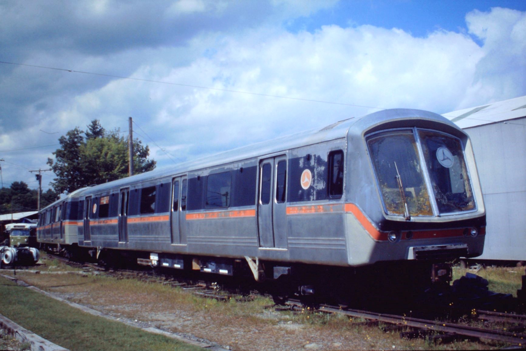

EJ Berry wrote:
The "modern" cars at Seashore are the "State of the Art" cars (SOAC, pronounced So-ack) commissioned by US DOT in 1972. Boeing managed the project and St. Louis Car built them based on New York's R-44 BMT-IND cars with a nose cone that precluded passage beyond the two cars.
I'm assuming the SOAC cars are these ones?
They appeared to be the most "modern" cars at Seashore on my visits there.

Yes, they are the SOAC cars. Note the US DOT Frisbee between the nose cone and the side door.
https://collection.trolleymuseum.org/br ... d=SOAC2RDC
That's a Philadelphia trackless trolley behind them. PTC 336 (Marmon-Herrington, 1955)

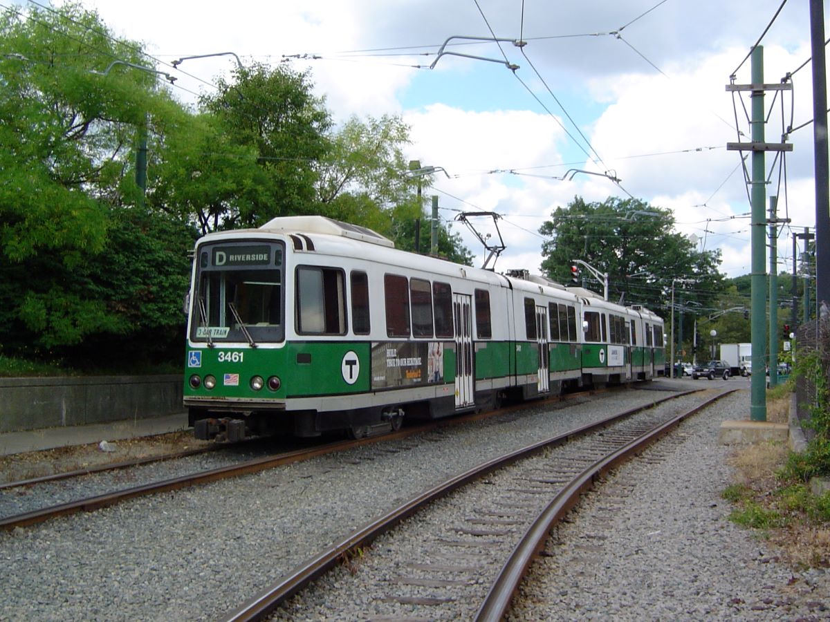

EJ Berry wrote:
US Standard Light Rail Vehicles (SLRV) were built for Boston's MBTA and San Francisco's MUNI. They were in service 1977-2007 in Boston and 1976-2001 in SF.
Philadelphia's SEPTA could not use the US SLRV as they could not take 33 foot radius curves (10 metres) or meet some of SEPTA's 19th Century clearances.
Did quite a few miles on the MBTA ones over the years on visits to Boston from 1987...
....but all the SF ones had been withdrawn from service by the time I actually spent any time in the City.
Wonder how many SEPTA Kawasaki cars will end up being preserved (as and when they can afford replacements..). Done a fair bit of travel on those since 2002 as well!
