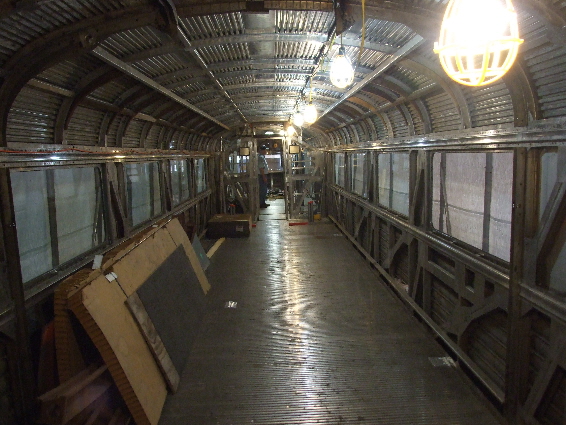

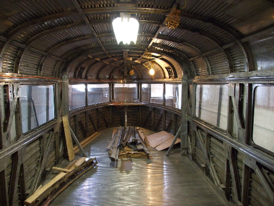

When I saw the unit in September 2013, the rear car was totally stripped out for rebuilding, whereas the other cars had been fully restored internally (from memory + the photos I took at the time).
Not sure how far they got with the rear car before restoration stopped, but it does at least provide a "blank canvas" if someone was thinking about a small control desk/box at the rear.

Thanks for the photos! When I visited there were a lot more building materials in that last car. Not much visible progress, but the materials to make a start were there.
