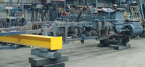

Answering several questions here.
The rear frame is in terrible shape. We are putting several heads together to make the best and most cost-effective repair. I suspect the poor engine may have been hit from the rear.
Sammy is in charge of the funding and I am not at liberty to talk about the finances of the project. Maybe Sammy will comment at some point.
JC McHugh of McHugh Locomotive, Sammy, and I are all in regular contact. We are all committed to doing good quality work. The McHugh staff is very skilled and talented and we also have some very experienced individuals available to help when needed.
I look forward to continue to share photos and news as this project moves from teardown to repairs and restoration.

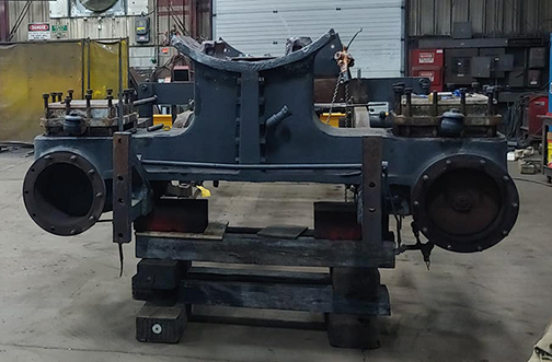

Sometimes progress is very slow when doing this sort of work. The bolts through the frame that hold the pedestal binders were removed with great difficulty and replaced with temporary hardware until new bolts can be machined.

 Post subject: Re: The Train that Wouldn't Die
PostPosted: Fri Jan 08, 2021 11:56 pm
Posts: 618
Greetings:
With all due respect, those bolts through the frame which hold the pedestal binders are usually "fitted bolts", that is they are tapered (1/16" in 12") and driven into place with a sledge hammer, which is why they are difficult to remove and why a commercial bolt will not serve the purpose.
Each bolt in the frame must be individually made to fit to it's hole, on a lathe with a taper attachment (or CNC), which has been reamed with a tapered reamer (1/16" in 12"), leaving a gap of about 3/8" between the head of the bolt and the frame. Then it is driven with a sledge hammer into the frame so it will be tight in it's hole.
Commercial bolts aren't tapered, they have a straight body and even if they don't rattle in the hole, they won't hold up in service, they will become loose and whatever they are supposed to hold together will become loose too...
At TangShan Locomotive Works, there was a small machine shop at the end of the erecting hall where they had a line of lathes with taper attachments. All the women who ran the lathes did all day was to make tapered bolts. A fellow with a small wheel barrow brought bolts out to the folks on the erecting floor, they'd try them out, sometimes they would ream a hole they were working on a bit larger to fit the bolt, other times they would send it back to be turned down a bit or set it aside to use in a hole which had yet to be reamed. Interestingly, the taper that they were using was a metric size, but the taper converted exactly to 1/16th to the foot.
One of the major changes that I specified in the construction of "YORK 17" built for Steam Into History, was that all of the frame bolts were to be tapered, fitted, driven bolts.
Good luck!
J.David
PostPosted: Sat Jan 09, 2021 2:01 pm
Posts: 2599
Location: Faulkland, Delaware
Yes, this is a good point. I should have included more info. The hardware in place is there temporarily so as not to leave the binders off for any length of time. McHugh Locomotive has the machine tools/machinist to replace the bolts with the proper taper and to handle any work required on the driving boxes. This will be happening in the coming weeks.

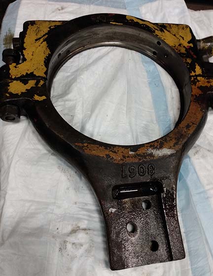

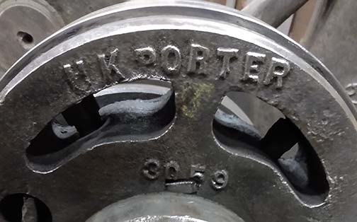

Work is progressing on the little engine that wouldn't die. Today we found a nice little surprise when we took apart the eccentrics. Finding H K Porter beneath all of the grease and dirt made me happy. A lot is going on and I will post a more detailed update later in the week.

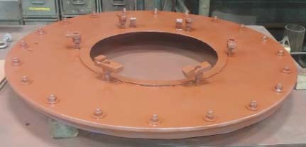

There are so many jobs that take time and effort when you restore a steam locomotive. Here is one small example from the floor of the McHugh Locomotive shop.
The metal ring that holds the studs for the smokebox front was badly wasted and needed much work. The holes must line up and have the right amount wiggle room. It's not critical but we don't want it to be an issue each time the front is removed/installed.
For every job that gets the big attention such as turning a driving wheel or fitting up bearings, there are dozens of jobs like the smokebox ring that are not critical but also not easy and require resources. Here is the finished job. Sorry there is not a better photo of the ring itself but I think most will understand this particular job.
It is nice that components are being finished and set aside for assembly.
