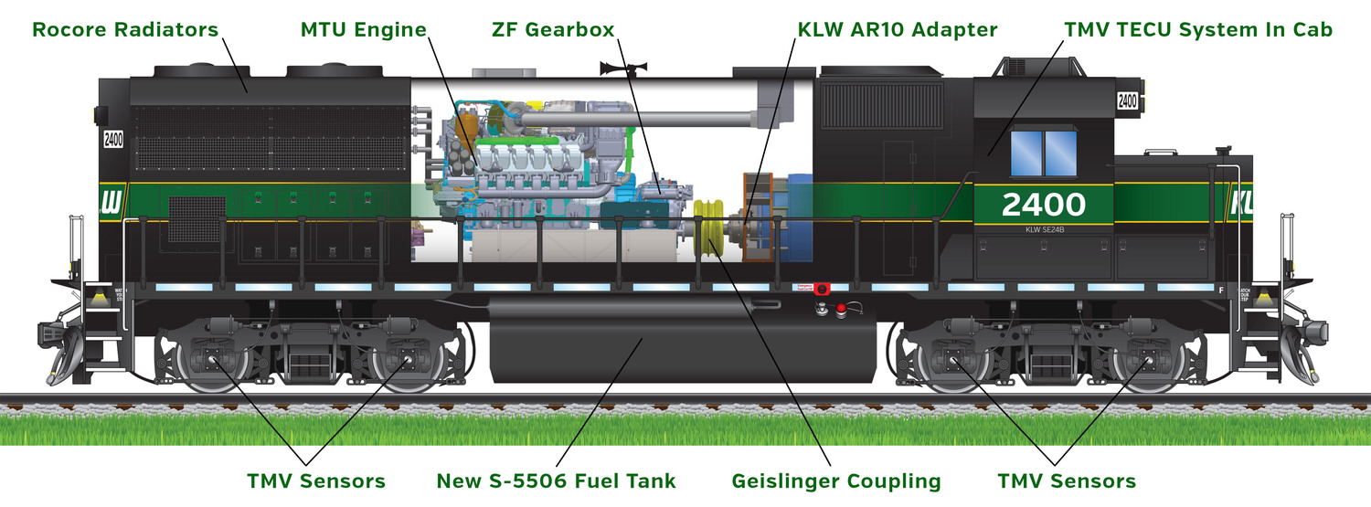

Someone mentioned KLW (Knoxville Locomotive Works).
These people have come up with a rather... neat package. I think it has potential.
Someone at KLW realized that MTU has come up with a Tier 4 diesel motor that needs no after-treatment. This already puts them ahead of the curve. But what they have done with it, is rather ingenious.
The MTU diesels they use, run at 1800RPM max. However, what they have done is gone to ZF and procured a 2 to 1 gearbox. Yes you heard me right a GEARBOX. Now it doesn't shift. Its a fixed 2 to 1 reduction. Why is this important? Well it means they can reuse a high degree of the electrical equipment found on your EMD locomotive. Yes I mean the AR-10, and everything on down the line.
So what KLW has come up with, is a Tier 4 rebuild, that uses a high number of reused components, with a diesel that doesn't need any special treatment or exhaust. Its got your standard boring straight pipe to the outside.
If KLW can make this reliable, they may have a winner here.
