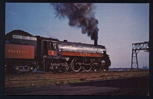

I just can't get my mind off poor ol' CPR 4-4-4 No. 2929 mouldering away down there. I was just by a couple of lovely stretches of Ontario trackage the other day where, on either one, she could easily stretch her legs into the 80 mph range! Now wouldn't that be something!

I believe it was Ross Rowland who once opined, he'd love to see the "Jubilee" restored and go for a track speed record.
What has been allowed to happen to that specific locomotive is unbelievably shameful, as with 3337, to "better" CNR Mikado. Or frankly, all the outdoor equipment.

"I believe it was Ross Rowland who once opined, he'd love to see the "Jubilee" restored and go for a track speed record."
Wrong Jubilee. While it might be fair to consider 2929 as the better two-thirds of a Royal Hudson, it was the F2a 3000s -- think of a Milwaukee A class adapted for solid-fuel firing with a four-wheel trailing truck -- that would have been the speed-record candidates.
Not saving a roller-bearing-rod GS4 or a B&O EM-1 was a crime. Letting all the F2as be scrapped was a sin.
The clear speed-record candidate at Steamtown was Repton, and nobody Stateside appreciated her enough to care.
(Incidentally, before any carping jeremiads about 2929 having "inadequate tractive effort to pull excursion-length trains" starts again, there is a precedent in Southern Pacific practice in the early 1920s with several classes of very fast Atlantics... get a good feedwater heater working, and put a booster on the trailing truck. That would make the locomotive the moral equivalent of a six-coupled engine (like 3713) for many practical duties... with very little 'adaptive tinkering' with designed or historic fabric.)

Overmod wrote:
The 2929 is rated for 26,000 pounds of TE, about the same as the BLW26. The 2317 is somewhere at 42,600 and the 3254 had that 53% that befuddled visitors painted on the cab.
Could the 2929 run an "excursion length" consist up the Pocono Main? Interpolating from the 2317's capacity to run six coaches up that grade with relative ease and eight with favorable conditions, let's say you are looking at 3-5 coaches. In my last active years up there, we were "high-fiving" anything over 200 passengers. That's 3-4 coaches. Keep in mind, anything more than 60 per coach gets cramped and one of the cars is going to be the CNJ combine for limited mobility accessibility, I think that car can seat 30-40.
