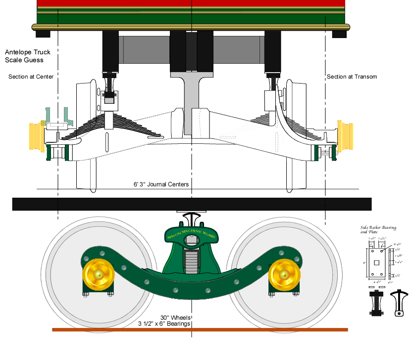

Resurrecting this thread re: the OP question. Has anyone else found anything on these curved frame trucks? I have searched the patent records, as many old periodicals as I can and not found anything more than a few more pics, some more helpful than others.
As near as I can tell, these trucks were only built from about 1866 to 1869. I have not found anything to indicate otherwise, and it seems like they disappeared altogether rather quickly, probably for the reasons stated below. I decided to scale the pics I could find and take a stab at reverse engineering them, taking into account the casting/machining abilities and other designs of the time. The drawings are not complete - there are some details like the shape of the inner spring landings and rocker link boxes that I didn't take time to finish - just conceptual at this point.
It appears they were meant to be a very minimal/simple design, but still there's a bit to them. The problem seems to be they look nice, but the design is quite flawed. If I'm reasonably correct, the flaws include; way too rigid, not capable of carrying heavier loads (without making them even more rigid and way too heavy and consequently not as aesthetically attractive), a maintenance headache, non-standard compliant (which wasn't much of a concern when they were designed), and probably too fragile as they approached their load limit. They appear to use a four-point suspension with rocker links above the springs. There are several other designs from around that time that share certain design characteristics like the rocker links and center pin, including from Hinkley and Baldwin as shown in the 1871 Weissenborn book. Side frames appear to be a riveted sandwich of three castings, also riveted to the one-piece bolster. The only add-on pieces would be the spring bundles, rocker group and binder/cover/name plate, and the journals/cellars/wheelsets. My version of journal is probably more guess than reality - they were probably more of an earlier Winans style like on page 301 of White's American Locomotives. Brake rigging was frame-hung, so not shown.
In any case, here are a few scale sketches based on the available photos. If anyone knows what happened to Wallace's Mason collection, there's a side-on photo of Highland Light c/n273 would be helpful if a hi-res scan were available.
And no, the colors are probably not correct for Antelope - they were suggested by a litho of Highland Light....
G.

Nice to see this thread come back to life, and with what may be some good speculation on the truck design, too!
I tried to look for another illustration of the Highland Light, specifically the photo mentioned. That didn't turn up, but some other illustrations, which included the "Central Pacific" style of tender truck did.

Train Detainer,
Thanks for making and posting the above drawings of the mystery tender truck that opened this thread.
In Arthur Wallace’s book MASON STEAM LOCOMOTIVES, I see the Highland Light, fig. 59, page 48 with these trucks. The author says this in the notes about the locomotive: “The customer specified curved sideframes for the tender trucks.”
I though this might mean that the curved side frames were the customer’s design concept. However, Mason also built the locomotive, Victor #32 about one year earlier than the Highland Light; and that locomotive too has the same type of tender trucks. About it, the author, Mr. Wallace, says this: “It [the tender] weighted 56,000 lbs. and carried the unusual curved sideframe tender trucks.”
So that would preclude the idea that the customer for the Highland Light designed the curved sideframe tender trucks; and strongly suggests that the trucks were Mason’s own invention. That seems probable, since Mason was known for his creative innovation and desire to try new ideas.
The photos I have seen of this type of truck show only the side frames and journal boxes with any clarity. Do you have other photos that show some of the internal details that you show in your drawings?
