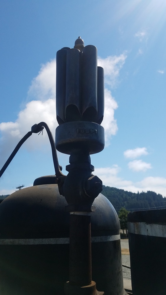

Polson 2 has a home built 7 chime whistle. This whistle has been on engine for at least 70 years, based on photographic evidence. If she sported a different whistle is was for a short time. If you want to hear the whistle any current Youtube video will be sufficient. The attached photo is a close up I was able to take a few years ago when I was working on the engine.
Aaron Zorko
