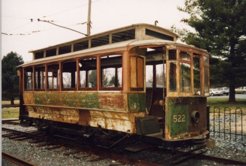

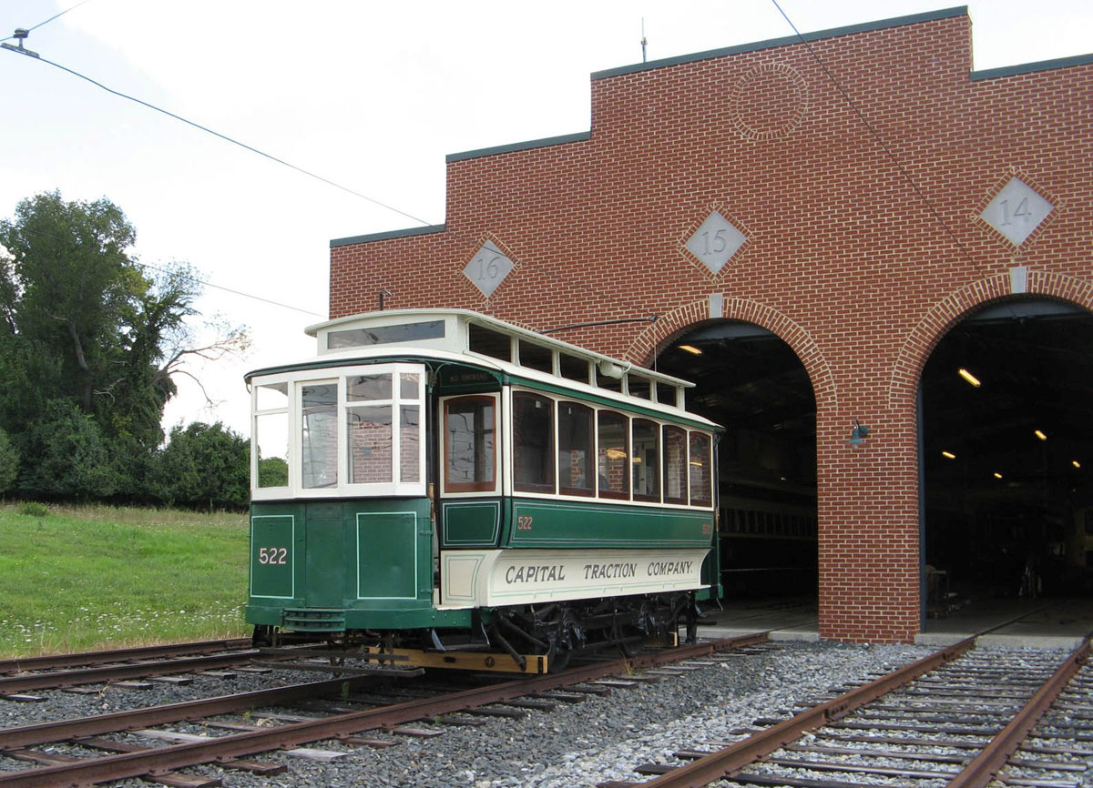

I submit as an example the restoration of Capital Traction 522 (American Car Co. 1898). After 117 years of service the original fabric of the car body was in poor shape and no longer represented its original use as a passenger car or its last use as a rail grinder.
Following restoration (reconstruction?) as a passenger car, the car body is now a mix of old and new materials. The new Lord Baltimore truck frame is also a combination of old and new materials.
In its current state, CTCo 522 interprets the first generation of electric street railway equipment in Washington, DC. As someone who enjoyed operating the car in its "before state," I would say the destruction of the earlier representation of the car is well worth the final object now presented in a new state of preservation.
Before
File comment: CTCo 522 before restoration.
After
File comment: CTCo 522 after restoration
