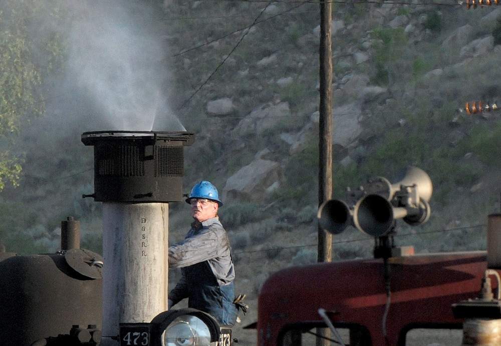

https://durangoherald.com/articles/40831#slide=0
Caption:"Steve Lewis/Durango Herald. John Harper of the Durango & SIlverton Narrow Gauge Railroad & Museum said spark arresters, which employ a screen and small water nozzles on the stacks of the steam engines, reduce the chances of hot cinders escaping and starting fires. Engine watchman Robin Schanbarger looks over a train returning to the station on Friday evening."
It would seem that D&SNG has thrown in the towel regarding coal-fired locomotives, what steam remains will likely be oil fired. I would have liked for them to experiment more with spark arresters from the late steam era such as the Japanese model you posted before, instead of such drastic changes as converting to oil (much less the purple and orange diesel I posted a photo of a few days back). But I lack the technical knowledge to be offering any advice on steam, free or otherwise.
