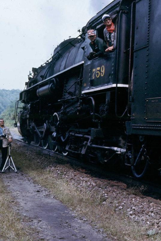

Ross - you don't have to have a Facebook account to view a public group. Just click on it and scroll down. I'm in your age bracket and have figured it out. BTW, I have great memories of my 1st railfan excursion in 1970 from Harrisburg to Horseshoe Curve and back behind 759. I think you were the engineer weren't you? Anyway, I copied the post and will paste it below for you and other Luddites.

Thanks WVNorthern. Yes, I was engineer on the eastbound legs of the Horseshoe Curve trips. Great memories. Glad you're well. Best, Ross Rowland
