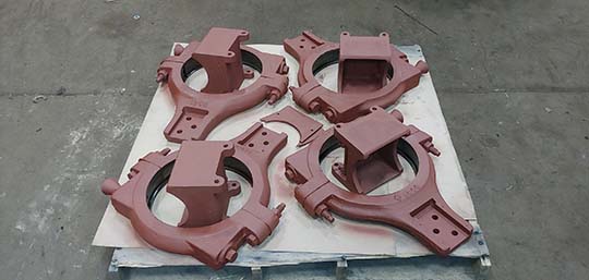

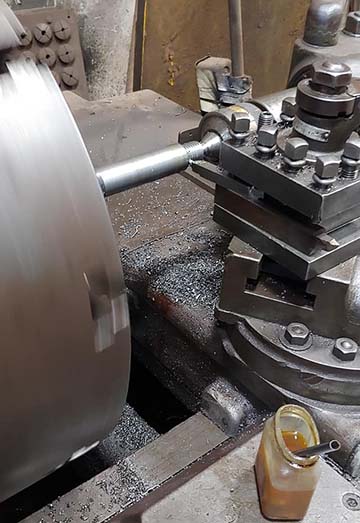

The McHugh Locomotive shop is humming with activity as work continues on the train that wouldn't die. We are nearing the end of the needle scaling and metal cleaning. Work has been started on the spring rigging. The spring rigging is in need of all new pins which are being made in house. These pins are the first new parts machined for Audrey in 60 or more years. Work on the eccentric straps is finished and they set aside for later. The oil cellars are also set aside. She was converted to oil sometime during her time at Coronet Phosphate.
Audrey is an example of a locomotive that was not only used, but used up. Probably not the worst candidate for restoration but in my estimation in the bottom 10%. Her owner, Sammy, is a man with a kind heart and a vision for her. Check back here to keep up with her progress.

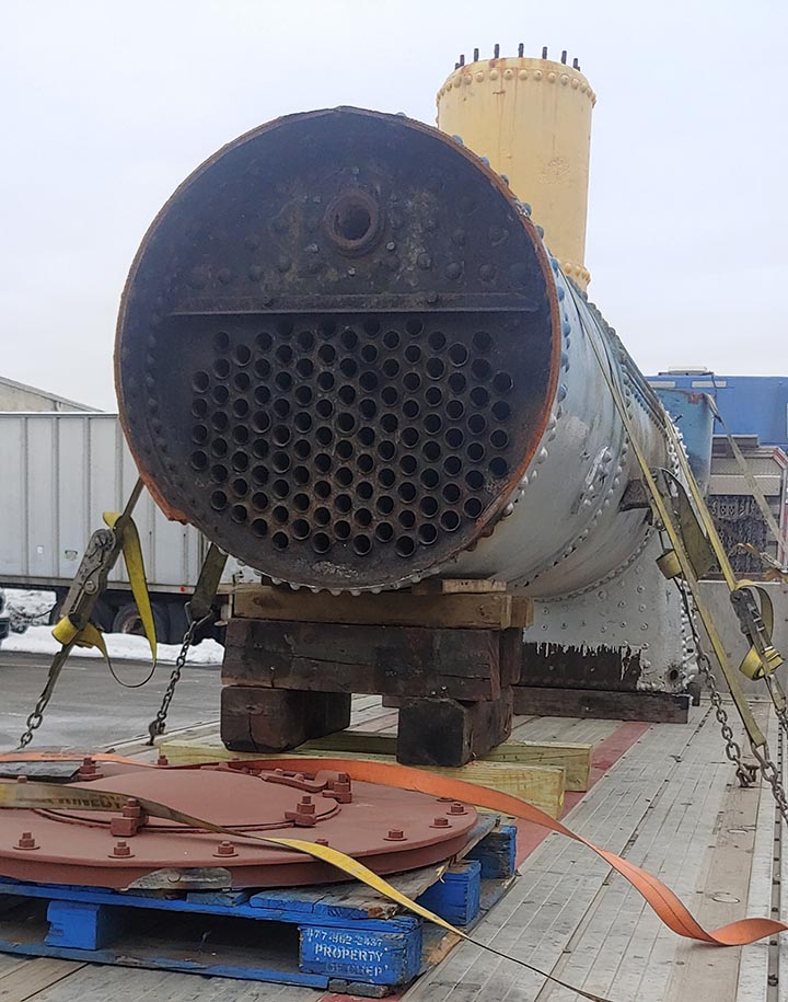

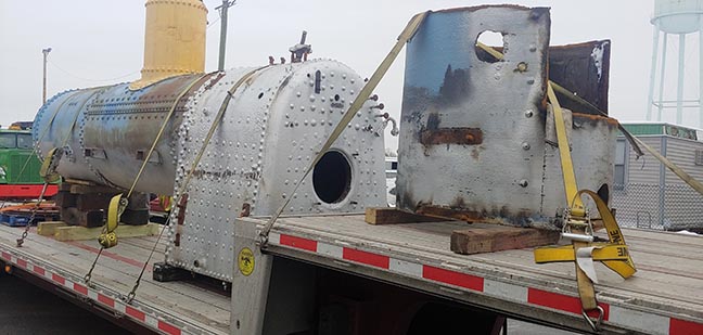

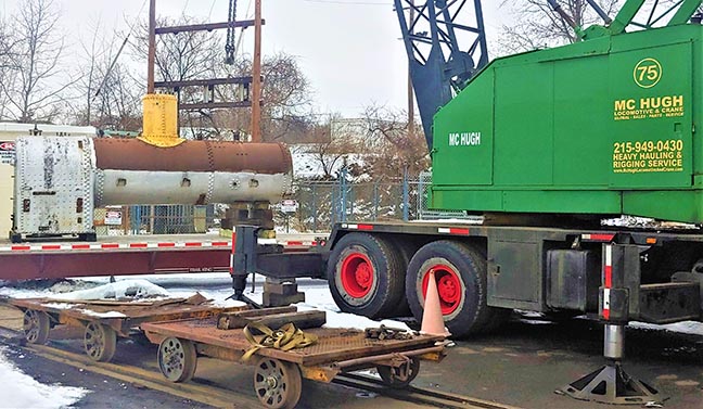

Today the boiler of Sammy King's former Coronet Phosphate No. 6 left the McHugh shop for the boiler vendor, Boilersmith Ltd. in Canada. A set of CAD drawings have been made by the vendor but the boiler will also be onsite to check and verify measurements.

If you need to ship something to Canada there is a customs process, I'd be happy to share what I've learned with anyone -- just let me know.

Thank you for the updates. It's great to see the progress they are making in a short period of time.
Is Boilersmith making a new boiler?
Roger

Posts: 2599
Location: Faulkland, Delaware
Yes, she will have a new FRA/ASME boiler.

Will the new boiler be constructed with flanged corner firebox and wrapper sheets? Threaded or welded staybolts?

Posts: 1676
Location: Byers, Colorado
Welded staybolts. Flat tube sheets and door sheet, flanged throat sheet and backhead.
