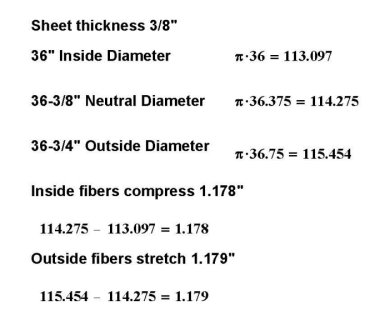

Explanation for the residual "spring" in the defective lap joint.
When the plate was rolled to make the boiler, by virtue of the process, residual internal compressive and tensile stress were installed into the boiler shell plate. As shown, by the attached calculations, the internal fibers of the shell plate had to absorb 1.178" of compression while the external fibers had to stretch 1.179" in tension. Because this is a riveted boiler it is safe to assume that it was never subjected to a thermal stress relief treatment that a welded boiler would see. Therefore, throughout its service life, the internal fibers retained the residual compressive stresses and the outer fibers retained the residual tensile stresses.
Without trying to invoke any voodoo bending moments into the equation, look at the depth of the crack of the subject photo. Does it not appear to penetrate about half way through the boiler shell plate? If the plate was rolled, the opposite and equal tensile and compressive stresses that held the boiler shell plate circular still exist. If you grind away the inside half of the plate, would not the residual tensile stresses tend to pull the plate out in a straightening manner? Similarly, if you were to grind half way through the outside of the plate, would not the residual compressive stresses tend to pull the plate inward?
Can somebody with a shop run out and roll a 1" X 3/8" piece of flat bar into a 12" to 18" radius and slice it half way from both sides with a hacksaw to see which way it bends?

This is a good time to introduce the Principle of Superposition in Strength of Materials calculations.
Please notice above the residual compression and tensile stresses are on the order of 1.0% due to rolling the plate. I uploaded the specification S-1 from the 1935 ASME Section II showing the expected elongation before failure to be greater than 25% for boiler plate.
The Principle of Superposition says that if a component is loaded in several different manners, each manner may be calculated independently and algebraically added to find the true resultant stresses.
If a beam is fixed to a wall with a point load on the end and also subjected to a uniform load for its entire length, then the calculation is generated for the point load condition and the uniform load condition, added together to get the actual stresses at any point and the true maximum stress in the subject beam.
The residual compressive stress due to rolling are insignificant in the lap joint stress equation. Please review the Strength of Materials section of a Machinery's Handbook for a more detailed explanation.

Seem, yes. This is where magnitude of the lap joint bending stress is the determining factor. Your first paragraph was correct. The residual stresses are overwhelmed by the bending moment stresses. Stress in a plate or beam is not simple or constant. Stress is constant in a wire suspending a brick. In a plate or a beam it can change from tension to compression and then back to tension, depending on the load and supports. If you have a Machinery's Handbook, read the chapter on Strength of Materials, three or four times. It has all the answers to this situation. Stay tuned.
