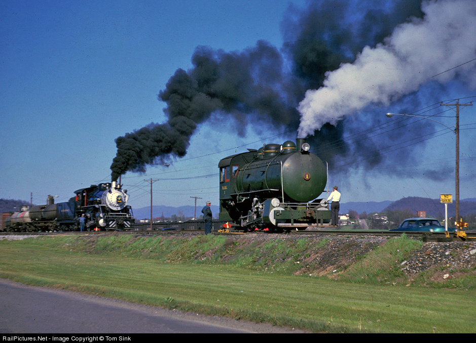

I'd always assumed that North American Rayon at Elizabethton TN had the last one, which stopped running in 1990 if memory serves. But in the past few years, I've heard of others running well into the 80s.
NARC 1 (a porter 0-6-0F) had the distinction of being what has to have taken part in the last interchange of steam with another carrier also running steam, with the ET&WNC (2-8-0s 207 and 208, now known as their original guises of SRR 630 and 722) on their tracks outside the plant, which continued until 1967.
https://www.railpictures.net/images/d1/2/1/9/3219.1258401444.jpg
