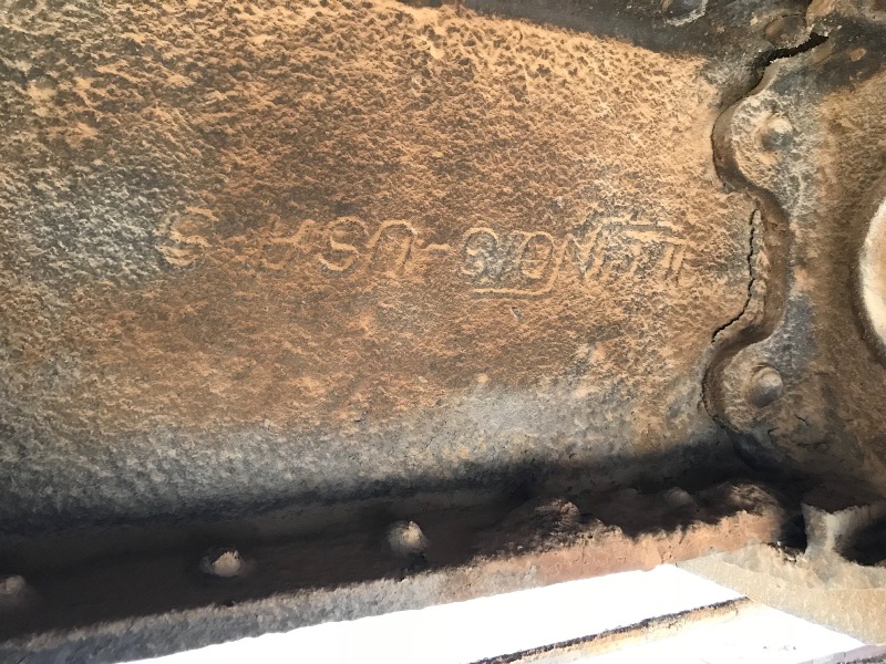

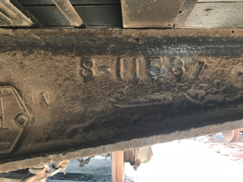

Unfortunately I didn't get any wider shots of the underframe (oops) but I did get a couple of close-ups. The casting to which the diagram plate was attached was one of the cross-bearers (terminology?). I've included a photo of that cast cross bearer - note the wheel and journal box in the background - and also a close-up of where it bolts to the center sill, which caught my eye because of the Illinois Steel mark.

BTW, Illinois Steel had five plants, most of them in Illinois (North Chicago, Joliet, etc.), eventually acquired Carnegie Steel and finally ended up as an integral part of U.S. Steel when it was formed.
The original underframes may be older than we were thinking. Illinois Steel Co. merged itself out of existence in 1901. Now I would suppose that the rolling mill rolls remained in use until they wore out, and I'm sure I've seen the ILLINOIS mill mark in interurban car underframes built in the 1906-1908 time frame, but those dates fit solidly into the era of freightcars with wooden body frames.
I also did some searching in the older issues of Car Builder's Dictionary scanned and available on the web. As I said earlier, cast steel components were rare in steel framed cars. They were rather common, however, as components for wood framed cars; first as cast body bolsters for use with wood sills, then as both bolsters and crossbearers with structural steel center sills intended to strengthen wood underframe cars. Both the 1906 and 1909 Car Builder's Dictionary show photos of the Ralston Patent Steel Underframe for Freight Cars, which has cast crossbearers, although not the exact same pattern. I'm sure there were competing products offered by others. These typically did not have side sills; the cars still had wood side sills.
Which would mean that NONE of the body above the frame is original. If someone is out taking pix of the cars either in Maumee of Perris, it would be useful to see the crossbearer/side sill connection, and the underside of the side sill.
