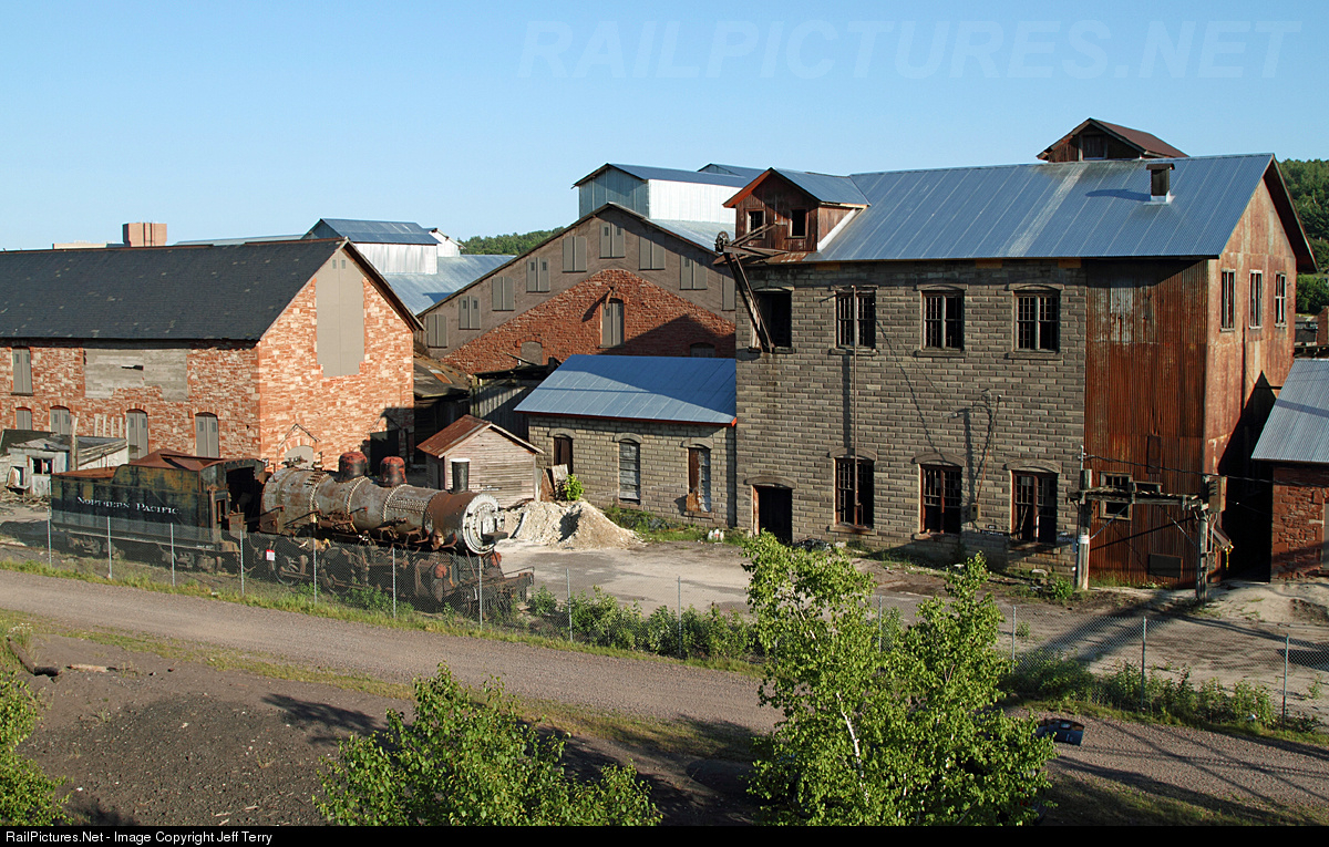

Tom Davidson wrote:
As far as I can tell there are at least two other C&NW R-1's in existence. Number 444 is at the Forney Museum in Denver, and 175 is displayed at the Quincy Smelting Works in Ripley, MI, with an NP tender.
Fixed that for ya.
http://www.railpictures.net/photo/514341/
http://rypn.org/forums/viewtopic.php?f=1&t=34129
