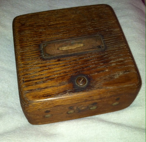

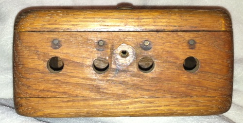

Hi! I found this little wooden box on a recent antiquing trip in GA. I've never seen anything like this before so I picked it up. Unfortunately somebody sadly decided to turn it into a bank and crudely made a cut through the metal plate on the top. The plate only has the partial name on there that says Hall and Signal Co (but I checked online and there was a company named Hall Switch and Signal Co). There are four perfectly aligned circular holes in the front and a circular hole (with a removable plug) on the bottom. Does anyone have any idea as to what this might have originally been used for or how old it might be? Thanks for your time! :-)

I'm gonna say it's a battery box for an old crank telephone..... Room for 2 dry cells inside....
The battery boxes mounted on top of the phone box.
 Post subject: Re: What is this wooden box?
PostPosted: Thu Jul 10, 2014 9:57 pm
Posts: 298
Hall Switch and Signal Company of Garwood, NJ (Inventor of the Hall Banjo and the Searchlight Signal,also built the first B&O RR cpl signals) was bought out by Union Switch and Signal Co. in 1925.
Your wooden box appears to be part of a telephone system and was used as a JACK BOX for plugging in.

Correct Kevin.
And as Hall equipment is so rare, it breaks the heart.

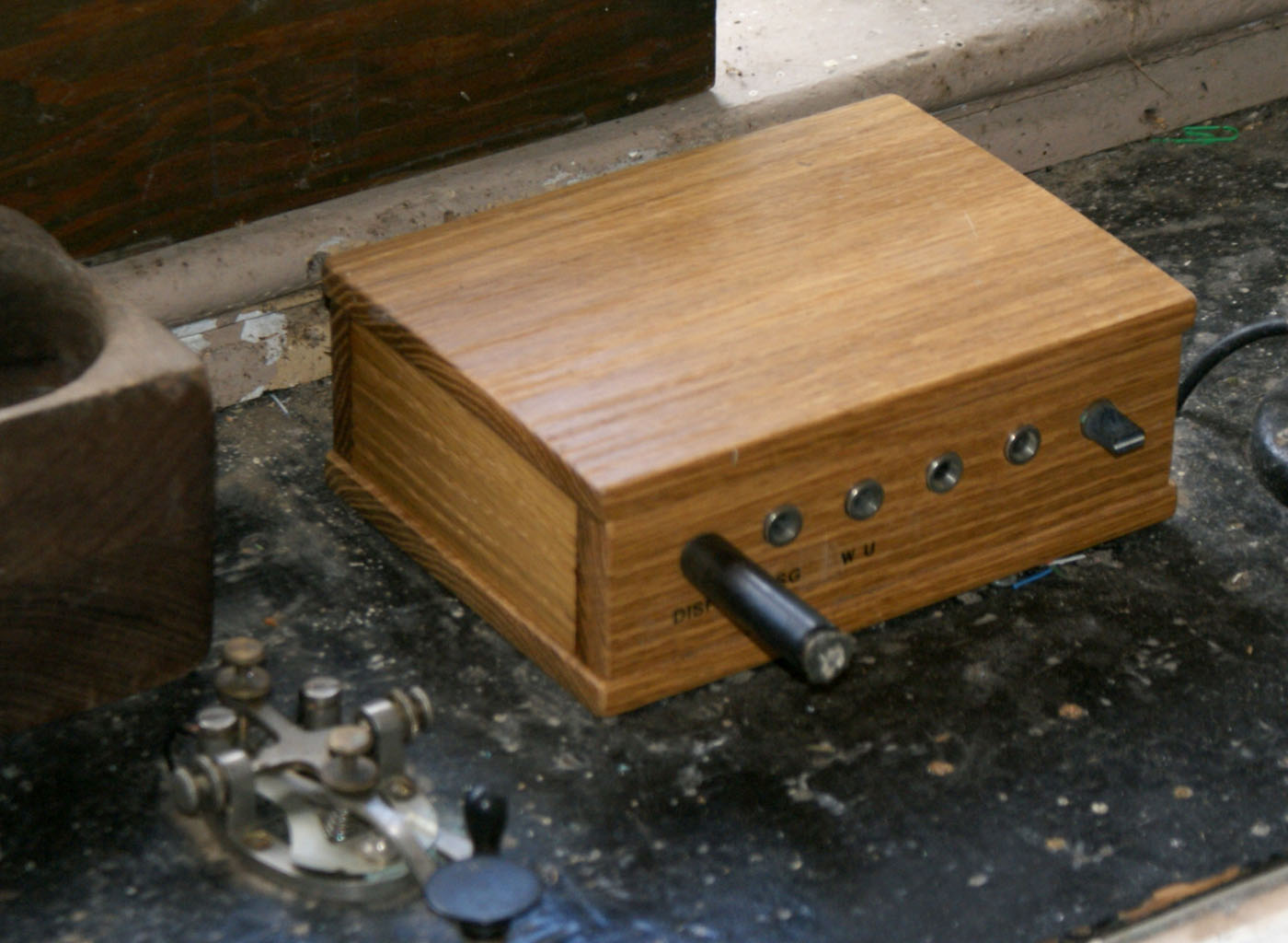

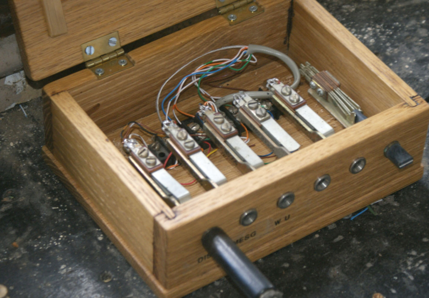

This is a replica switch box I made for the IRM's signal department. It is in the old station office and is used to switch the key to several different lines via the shorted 1/4” plug.
Western electric patch jacks and plugs are still available, even new. The 3-conductor version in use at many telephone and broadcast facilities.
The jacks in your box were attached with a flat head machine screw from the face.
