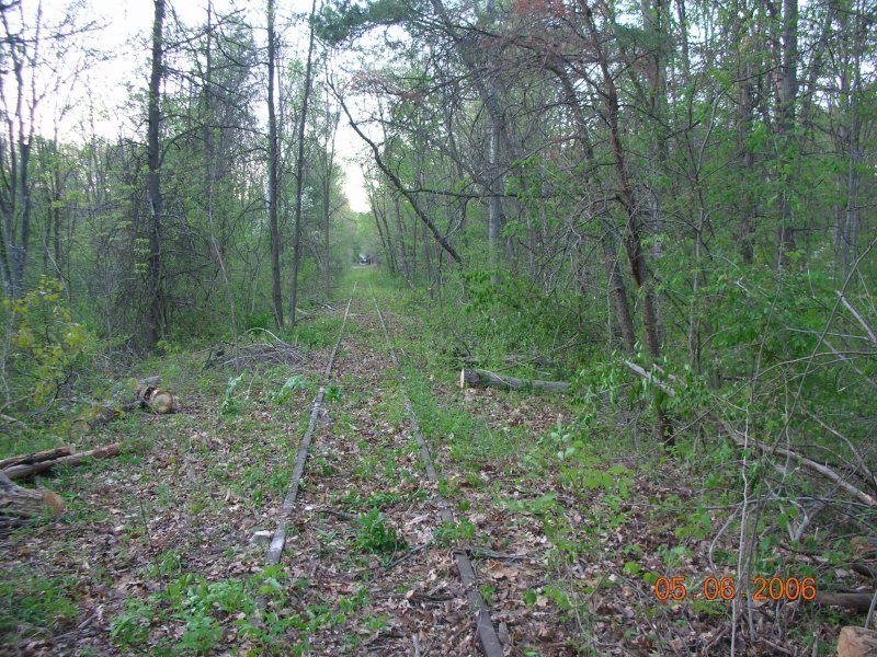

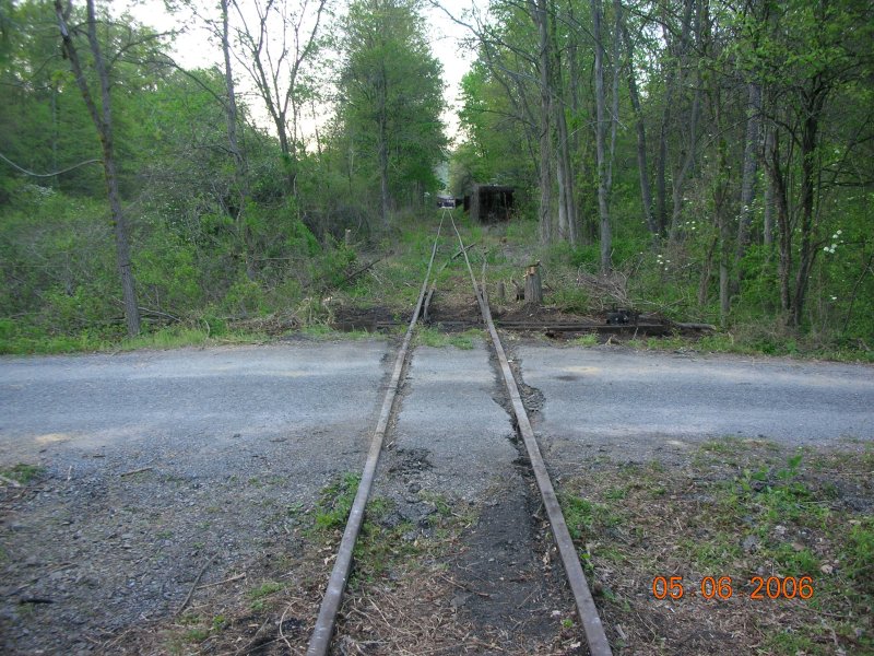

Looking toward Rockhill from Oddfellow Cemetary road, just beyond the previous end of cleared track (at the switch frog.) The switch machine had just been reinstalled a few hours before this photo.
Looking toward Rockhill from the current end of cleared track.
I am not part of the crew performing this work, but my understanding is that the current work will involve gauge bars but few ties. It is intended for speeder and MOW type vehicles. There are a few ties under the organic debris and the track will support an M series Fairmont once brought into good gauge. cr6358 can proabably give better info.

The ballast is still there under 40 years of organic debris. Ties are pretty much gone, though. With well placed gauge bars the rail will support speeders. This has been tested and proven up to an enclosed M series Fairmont.
The suspended rails was the site of a bridge built in 1872, but was long ago converted to a culvert. The fill was washed away by hurricane Agnes in 1972. It is one of several washouts on that part of the line, but nothing there is insurmountable should the desire to clear the line materialize.
