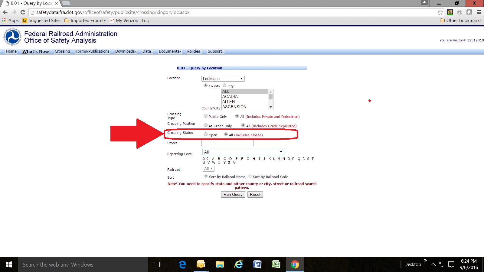

“Not surprisingly, the crossing does not show up.”
If a crossings was ever included in the FRA’s inventory, it will be in the database. However if it was officially closed, you need to set the “crossing status” toggle to “All (Includes Closed)" See attached.
/s/ Larry
Lawrence G. Lovejoy, P.E.

Larry,
Thanks for the tip on the "closed" tab, and there is also a "history" tab within the data base.
However, none of the 3 crossings in question show up in the database.
All three of them were active as late as 1969-70 but none of them show up now.
