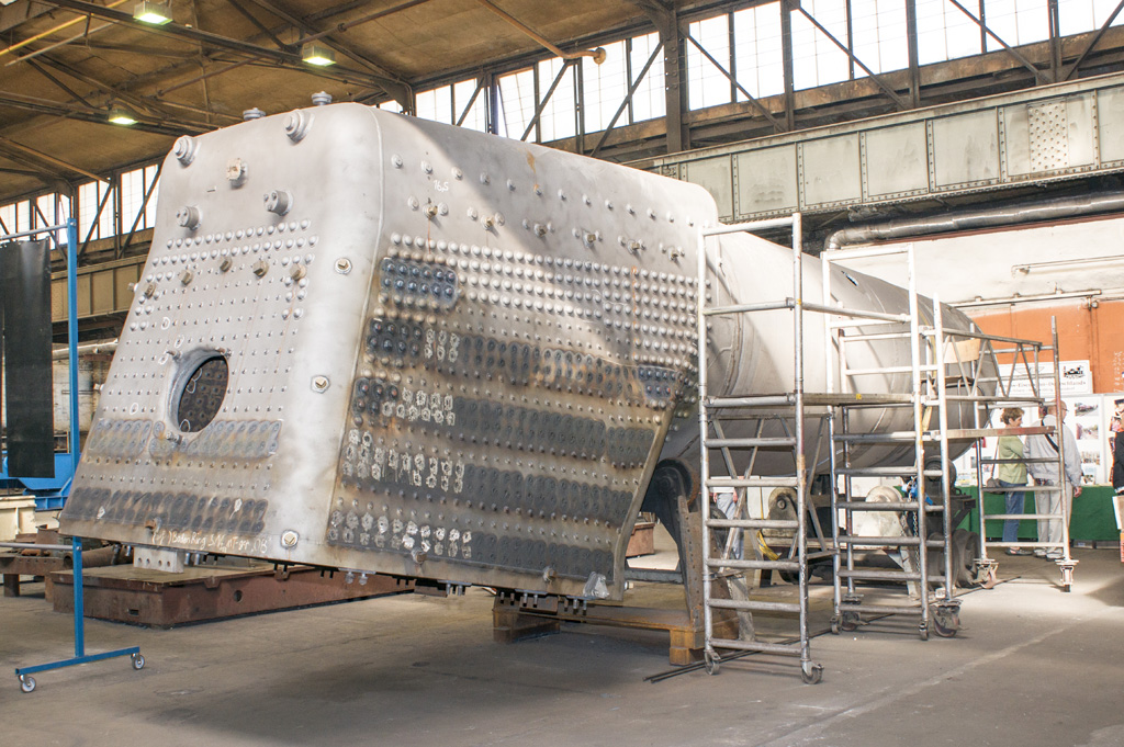

Tornado Boiler Back to Meiningen Link
"Her boiler was lifted from her frames and dispatched to DB Meiningen Locomotive Works, Germany, where it was built, for overhaul."
"The main item of work during Tornado's intermediate overhaul will be a full internal inspection of her boiler, requiring the removal of all of the tubes, as the boiler first steamed in January 2008. As a precaution the firebox foundation ring corners will be renewed and a significant number of stays replaced. The boiler and smokebox have been sent to DB Meiningen to carry out this work in order complete it in the shortest possible time. The boiler is expected back from DB Meiningen at the end of January 2015."

The basic UK boiler regime is that boilers should be stripped and internally examined every ten years, but every seven years for locomotives operating on the national main lines.
Occasionally you will see "mainline engines" working out the last few years of their boiler tickets on private heritage lines, but not many can use Tornado in regular service.
The seven years will be up in January, so this is routine, and anything that might give trouble in the next seven years will no doubt be done at the same time.

The Tornado boiler weighed 21 long tons when fitted, which may have been without tubes. The weight of the whole engine is given as just over 105 tons.
On a lot of UK engines there is no option but to remove the boiler for overhaul as the bottom of the firebox is tucked between the plate frames on most designs. There is no other way to examine the outside of the firebox and foundation ring fully.
Being in a small and tightly packed country can have its advantages, I recently had to hire an 80 ton crane to put the frames back on the wheels of an 0-6-0; £600 for half a day. I get the impression that transport and cranage charges are far higher in the USA.
