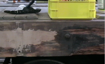

With regards to the rehabilitation of BCER 1225 (A 1912 St. Louis Car. Co. built interurban) we found, after removing the side plate, wood rot on the some of the wood. We had heard about Abatron, but found there was not a distributor in the Greater Vancouver area. As such we were pointed towards a product out of Seattle called "End Rot" and "Sculpwood" sold by a local company. We found it was useful for our purpose.
"Sculpwood Moldable Epoxy Putty
SculpWood is the epoxy putty component of The EndRot System. SculpWood is a 2-component, solvent free, kneadable epoxy resin putty. It is moldable, carvable, lightweight, strong, and exhibits excellent adhesion to a variety of substrates. It is easily sanded and will accept paint, screws and nails. It is most commonly used in conjunction with System Three RotFix, a low viscosity wood sealer and consolidant. For more details about the EndRot System see EndRot.
Recommended Uses:
Use SculpWood for replacing missing sections of windowsills, frames and furniture or for adding new sections to existing structures.
File comment: End rot on the right, then sculpwood.
