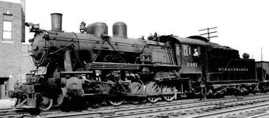

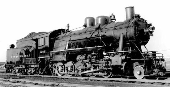

America built two batches of 2-10-0s for the Soviet Union; one during World War I (of which the Frisco and other "Russian Decapods" were some that stayed stateside); and another during World War II. It appears that both ALCO and Baldwin built some of each.
Examples of both batches survive in the former Soviet Union. They were classified as YeA, YeM, YeS and Ye1. I am not sure which is which; I used to think that the WWI batch was one and the WWII was another; or that the Baldwin built locomotives were one class and the ALCO another. But; what little builder's data I have doesn't support any of this; so I am really not sure.
The main way to tell the WWI locomotives from the WWII locomotives are the shape of the domes. The WWII built examples appear to have a taller sand dome, while the WWI examples have a taller steam dome. There is a picture of a WWII examples (Yem 3927 + Yea 3736); the sand dome does appear to have been raised with some sort of extension in the middle:
http://www.survivingworldsteam.com/news.htm
Compare it to a "Russian Decapod" that stayed stateside:
In addition to North Korea; some of these went to China. Colin Garrett photographed this one at Jalainaur, China; it appears to be a WWI example (or is it WWII; the steam dome looks wider):
They were classified as DK in China; one of these is derelict at Baotou Steelworks.
Some of the WWII examples were also sent to Finland, where they were classifed as the Tr2 class. One example is preserved at the Hyvinkaa Railway Museum; here is a beautiful live steam model of one. Notice that the steam/sand domes are different:
