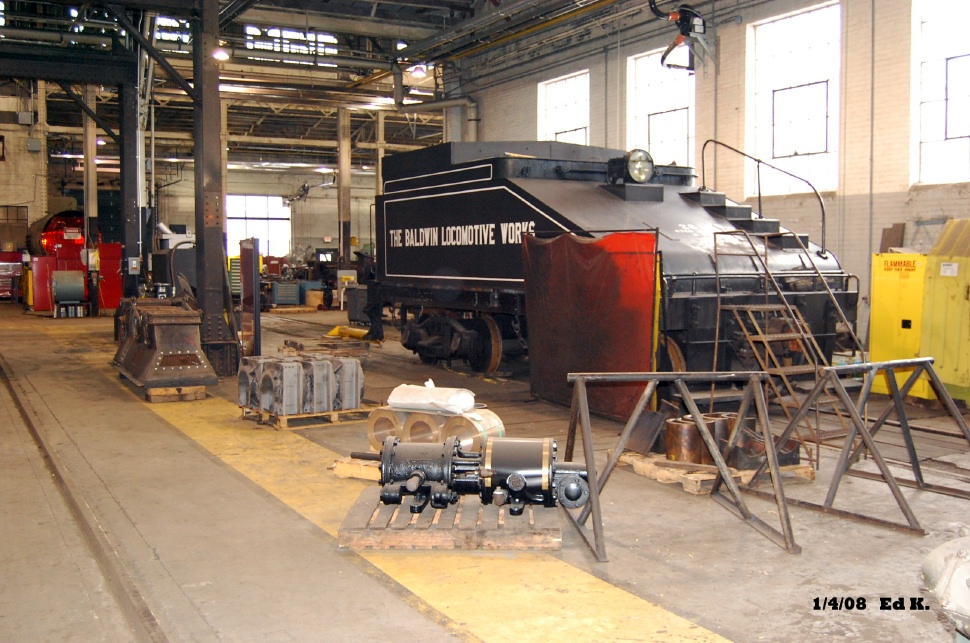

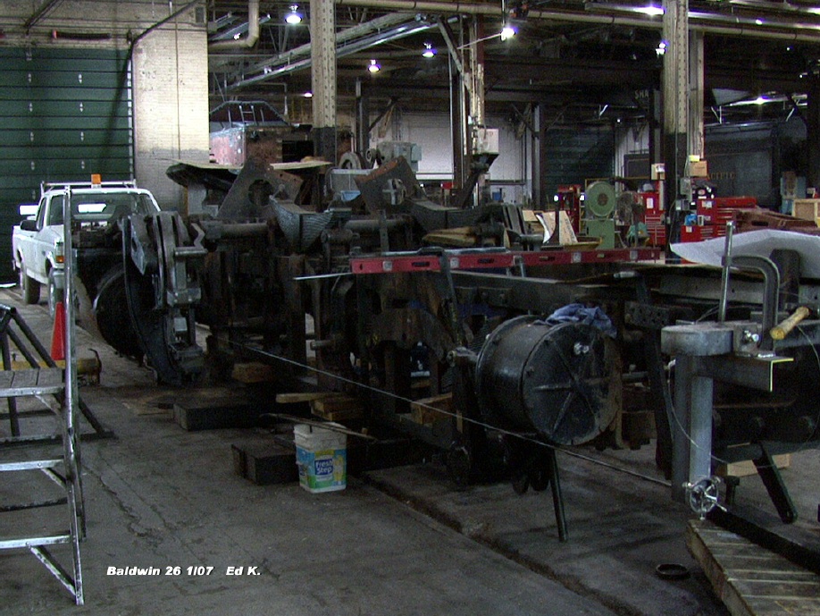

A couple of photo's of BLW. 26 last year at Steamtown shops.
Ed K. cp Laurel Run
File comment: BLW. 26
Ed K.

File comment: BLW 26.
Ed K.
