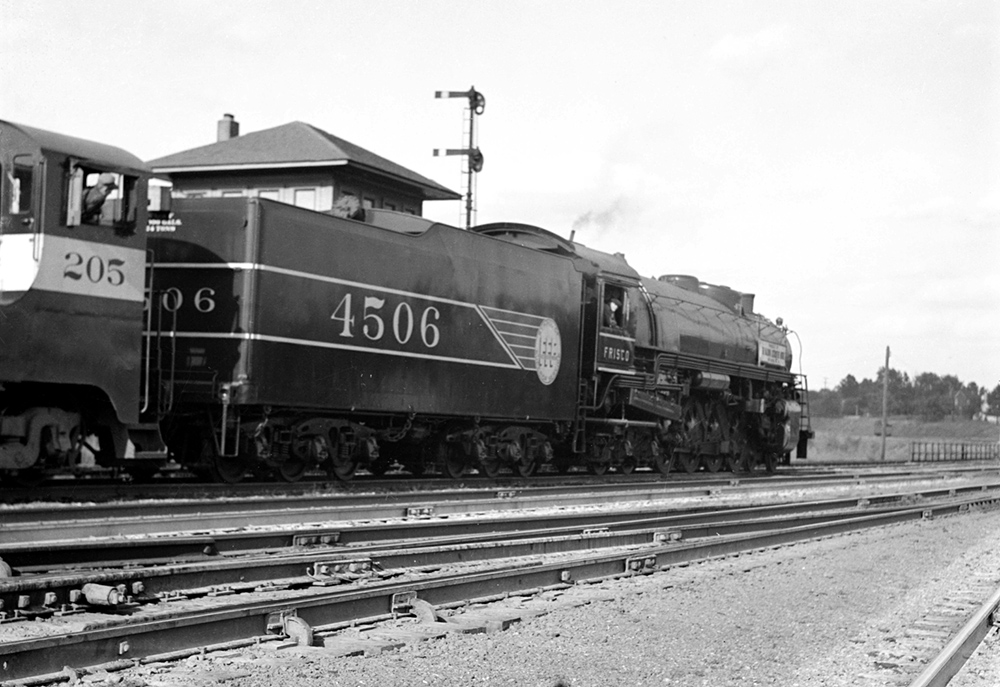

In 1942 Frisco took delivery of their first 15 of the 4500 class 4-8-4s from Baldwin. They were delivered to the Lindenwood yard (St. Louis) by the Terminal RR Assn via their belt line which ended at Southeastern Jct. This is the 4506 being shoved toward the roundhouse by another Baldwin product, Frisco 205, a VO-1000. The BLW sign is on the running board and the engine messenger is sitting in the cab. His little stove's stack can be seen above the cab roof.
