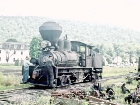

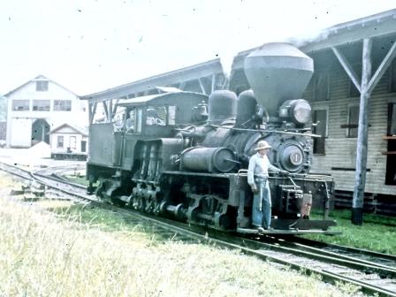

Here are two shots of #1 taken July, 1956 in service. Sorry about the color fading!
Peter Schmidt

Thanks Pete!!! That's what we are looking for!
