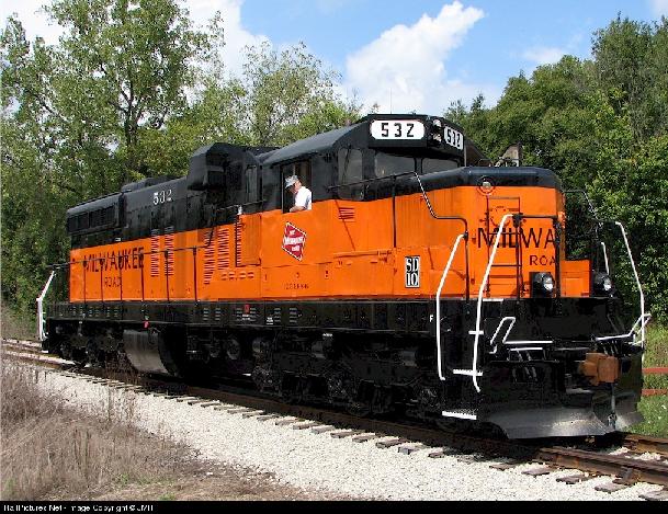

We have a contractor in right now replacing some power assemblies in Milwaukee Road SD10 #532 and he told us today that the prime mover is not a 567 C block as we had thought (and that records from Canadian Pacific / Milwaukee Road show). I know that a few SW1200's were built in the mid 60's with a 12 cylinder 567 E, but didn't realize that such a thing existed as a 16 cylinder in locomotive service. Does anyone have thoughts on this? Could it be that when the Milwaukee Road rebuilt these engines into SD10's in the mid 1970's that the installed different prime movers? Would they have purchased new ones from EMD? Could it be that the contractor is mistaken?
Thanks in advance for any ideas.

Jeff,
Thanks for the note, your explanation helps quite a bit. The contractor indicated that the five power-packs that we ordered were for a 'c' block and since ours is an 'e' block, they aren't right so he's exchanging them for us. He says that the power-packs are almost identical except for the exhaust area that is slightly different which would allow exhaust to escape into the crank-case and would cause an over pressure condition.
I didn't mean to pick on the contractor, but I've had a few that didn't quite know what they were talking about in the past, didn't want to rule that possibility out. Was there a reason why the Milwaukee wouldn't have just had them include 645 packs in a new block other than standardization?
