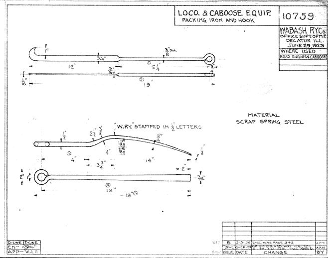

Does anyone have drawings of a full set of journal packing & inspecting tools? If not could you post a photo with a ruler in the shot for scaling.
I have a drawing of the packing tool (vee tipped handled flat bar), found in a Locomotive Cyclopedia, 15th edition IIRC. What other tools are needed other than the hook (rod with a 90 degree bent tip), IIRC it was mainly for pulling old pads/waste and feeling the axle surface?

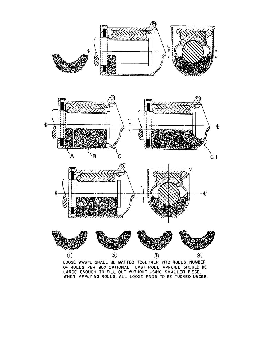

What is the usual size of a waste bundle before packed into the journal box? The pulled bundles looked to be roughly 6x3x3, should they be tied at 6x4x4 to allow for compression room or should they be thicker?
How tight do you compress the packing?

I prefer the packing iron with the slight bend and the V tip than the hook. That slight bend makes it easier to reach the far back corners of the box. The little nub also is easier to open the box.

Here is the blueprint for a set of Wabash journal packing tools.
Steve Zuiderveen

Army instructions as to how to roll your own packing. Now all you need is a bucket of well soaked long fibre waste.
Steve

Yes, you want to assure the mop yarns wick oil up from the bottom onto the journal surface. Roughly parallel to the rail would work well. Folding them in half depends - no point having half the yarns not reaching from the oil up to the journal.
Again, short term temporary until the journals can be polished and the proper packing material installed.

Mr. Johnston and Mr. Deck:
How long are the waste strands from your supplier(s)? The last batch we received is okay for cleanup and general locomotive sujing, but the strands are only six inches long, which is inadequate for a proper "bird's nest." We have found twelve inches to be a minimum strand length for making rolls that keep their loose ends in the journal sump.
I also prefer a yarn diameter that is @ 0.125 inch, though this is a matter of preference. The thicker strands seem to stay put.

Agred - threads like you would use in your sewing machine are almost useless in this application - you need knitting yarn size waste for this job.
The wool waste which Dave Johnston mentions comes in continuous hanks which are at least 200 feet long. In fact we have to divide one roughly in half to get the quantity needed to pack an armature bearing on a traction motor. We do this by untying the hank and counting off the number of turns needed, and then re-tie into separate hanks.
The waste strands are about .125 inch diameter.
