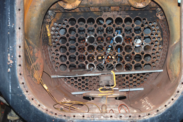

I visited Harrison Street on Saturday morning to see how the work on 261 is progressing. Much has been done, and much more remains to be done. Here's what's been done (since September 15th):
1. The exhaust system components have all been removed and set aside to allow removal of the tubes and flues.
2. Superheaters have been removed, numbered and stored.
3. Superheater header has been removed.
4. All but about 30 tubes are out of the locomotive.
File comment: View of the boiler looking into the firebox.

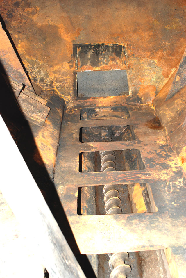

The tender has been cleaned out. Below is a view one seldom sees, of the automatic stoker's auger

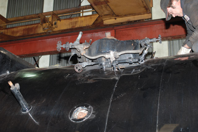

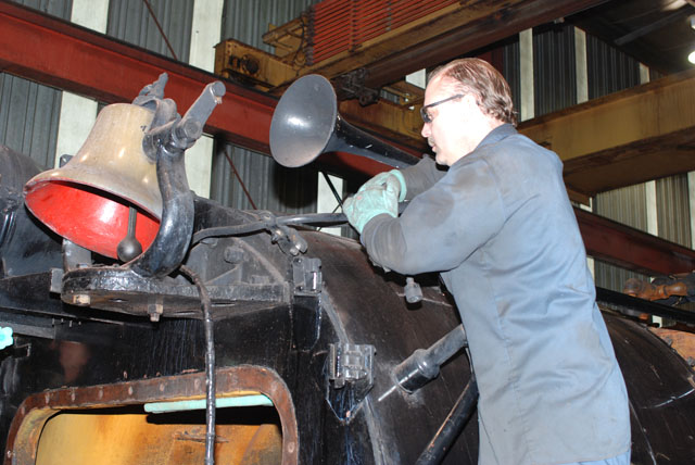

Yesterday, while I was there, they were in the process of removing the fireman's side handrail and stanchions. Electrical wiring for the Mars light, and the markers runs inside the handrail, so the wiring was first removed. In the second image below, Brent is disconnecting wiring to permit removal of the handrail. In the first image, Jon is on top of the boiler working on jacket removal. You can see the empty stanchion where the handrail has been removed.

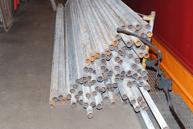

200 2.25" boiler tubes in good condition are available. Well documented, used only two years. PM me if you have an interest.

dumb question, if they only have two years use, why remove them?
thanks

Well, because some of the flues could not be relied on to stay tight for another two years until inspection time. Therefor, to make as sure as possible that nothing would go wrong, they were replaced.

Just for clarification, The flues that were replaced two years ago physically would have been good for several more years, but because the 15 year inspection was due, thay all had to come out so that the interior of the boiler could be inspected. These tubes could have new ends welded onto them and be reused, but the extra work is not worth the hassle. The diameter is pretty standard, so they could have the torched ends cut off and be reused in a shorter boiler. (These flues were just about 21' long when installed, so there would be a good 20' of usable flue left.)
We tried in the early years to sell old staybolt caps and short lengths of old flues, but there really wasn't a big enough market to justify the extra work, and in some ways it was counterproductive in that some people who bought those didn't buy any of the other items on sale that they normally would have purchased.

Do you have the original material certifications for those flues? Not much point explaining to your friendly boiler inspector where the "mystery flues" came from (especially for applications outside of the FRA bounded railroad universe).
If you have the certs, you might want to let the steam traction community know about the flues as well.

As Mike Bailey alluded to, all the documentation is there. Anyone who has a serious interest in these tubes can have all this information. It only takes a phone call to get started.
