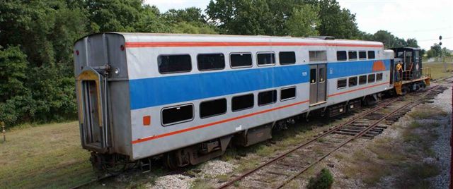

Earlier this year, METRA (the Regional Transportation Authority) donated 4 ex-Illinois Central Highliner bi-level Chicago-area commuter cars to our museum. There are a number of problems we have in the future utilization of these cars, the main one being that we have no overhead at the museum, and are not likely to install any in the future. I recalll reading in an old issue of the STEAM PASSENGER DIRECTORY that the Michigan Transit Museum in Mt. Clemens, Michigan ran a couple of CTA elevated cars in conjunction with one of their diesels, with the train being operated in one direction from the diesel locomotive, and in the other direction from the "L" cars with the diesel providing electricity. I also seem to recall other places where this was done, all where there was no catenary for the electric equipment to operate from. I am wondering how this is done, and if there are any problems in doing it? Any information is greatly appreciated.
Shown here is a photo of one of the METRA cars being moved onto a display track by one of our diesel locomotives.
Les Beckman (Hoosier Valley Railroad Museum/North Judson, Indiana)
