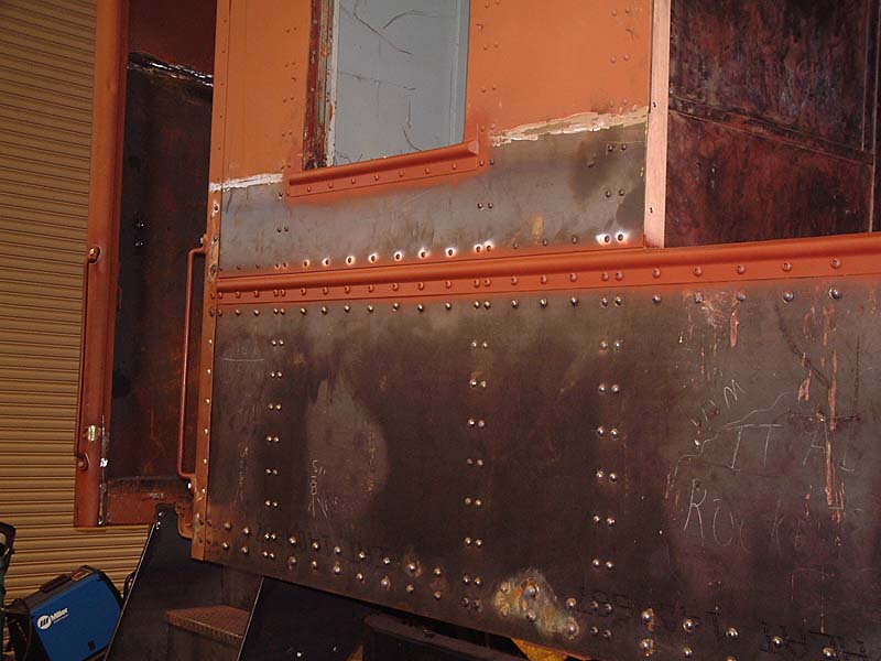

I didn't recall a flat spot on the bolts, so I went to the parts room to take a look. The "flat spot" that shows in the CAD drawing is where the allen wrench goes. The rest of the head is rounded.
I have tried to attach a photo of a repair that is a mix of rivets and button head bolts. Belt rail and above is all button head bolts, below the belt rail is rivets, except at the side sill. If you look real close, you can see a few button heads in amongst the rivets in locations we could not put a rivet. This was before we filled in the heads. When completed and painted, they are very difficult to pick out.
JohnB
