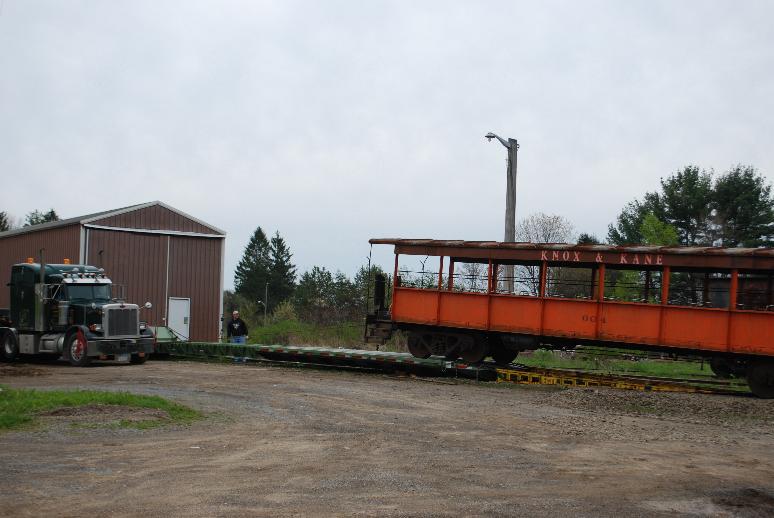

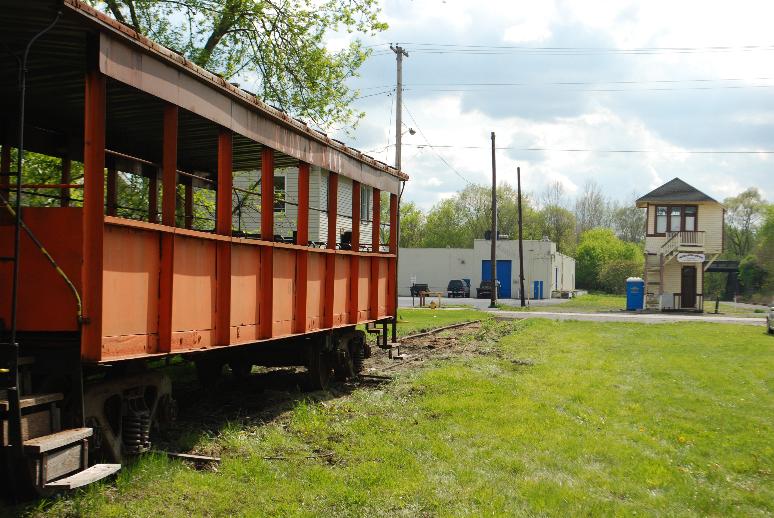

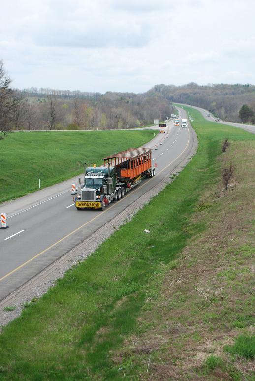

A week ago Monday, the Beaver-Lawrence Railway Historical Society (once the Beaver Valley Junction Chapter of the NRHS) moved K&K open car #604 from Marienville to New Castle, PA. All in all, the move went relatively smooth with only a few minor issues of the type associated with trucking something that was designed to move on it's own wheels.

Third, we kept in contact with the mover over the winter, which allowed time for issues to emerge and be solved, such as choosing loading and unloading areas. E-mail was a help as we could send photos of each area and discuss the pros and cons of each.

I'm sure there's more but that's what comes to mind now. In the end, we took 3.5 hours to load (vs. the [u]minumum[/u] two hour estimate), but made up time on the road and arrived about one hour after 'the advertised'. All in all, a successful move.
What went wrong or could have gone better? The loading site could have used more gravel, particularly between the rails... this after a late change in trailer that resulted in the truck needing to pull into the loading area rather than backing in. The air line on one end of the car did not quite clear the trailer gooseneck and was removed. We could have used one or two more people at the loading site. Having a forklift at the loading site would have helped and probably could have been arranged with advance notice.
