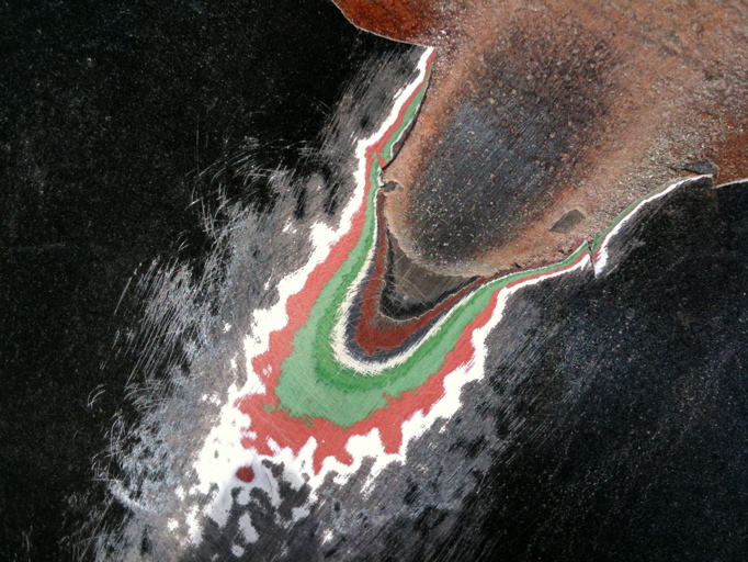

Finally, internet. Here are the paint layers.
The blisters fail between bare metal and first prime coat. When peeling blisters, the putty knife will keep going with little effort, but the failure point will shift to between the first black and next prime coat. The museum received the locomotive in green paint. They painted the light-barn-red 14 years ago and the black on white 4 years ago. As said, the black on white has performed well where on bare metal. Otherwise it is constrained by the performance of the underlying paint.
