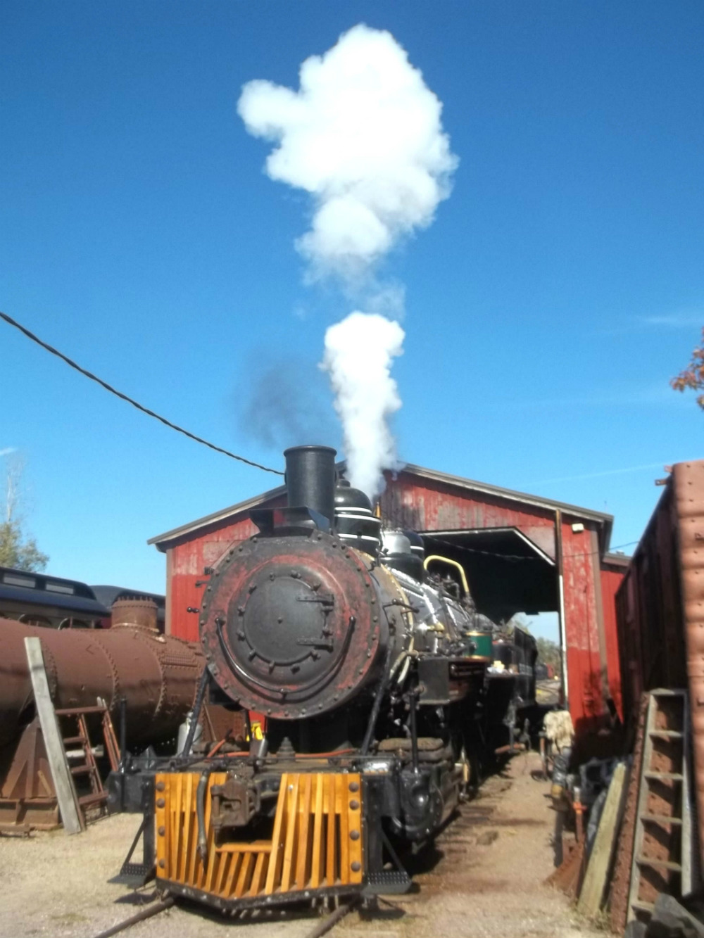

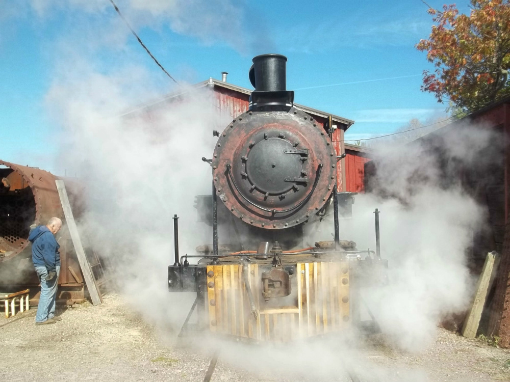

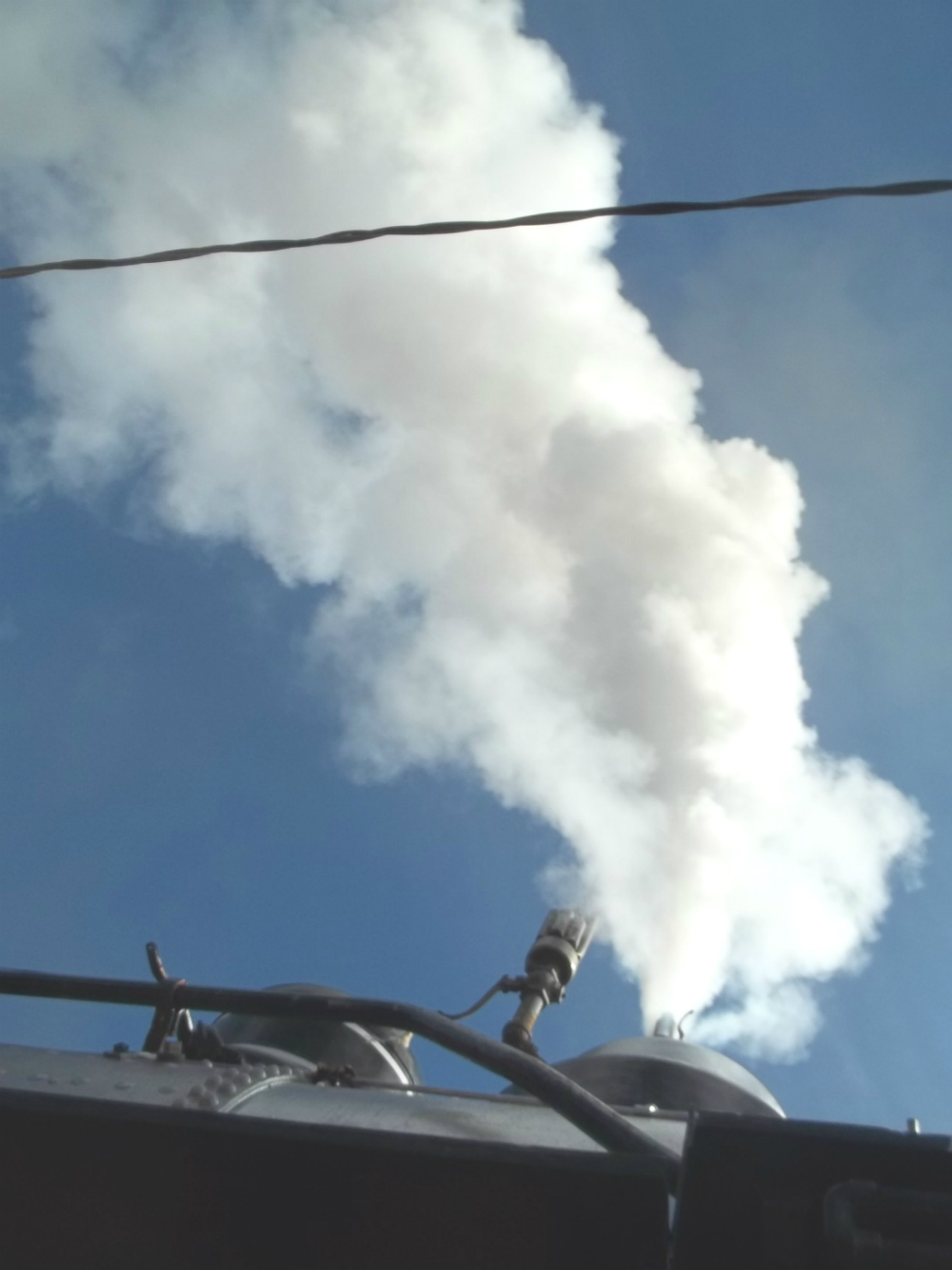

Sunday A.M. saw the pop lifting, steam passages blown out (Skip watching), and more whistling to passing museum trains. It gives a grand feeling to members and visitors alike.
